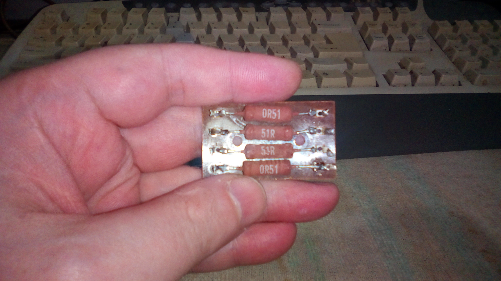

Aham...#1 Yesterday I built that circuit I mentioned from : #6 ; (not all of it, only a module); (you can see it in the picture, in the top left corner, having a 10R 10W cement white long brick resistor on it). This circuit didnt worked for resistors. Only for very low resistors like 10R and smaller. That LM317 current driver circuit is good for leds and transistors. Not resistors.

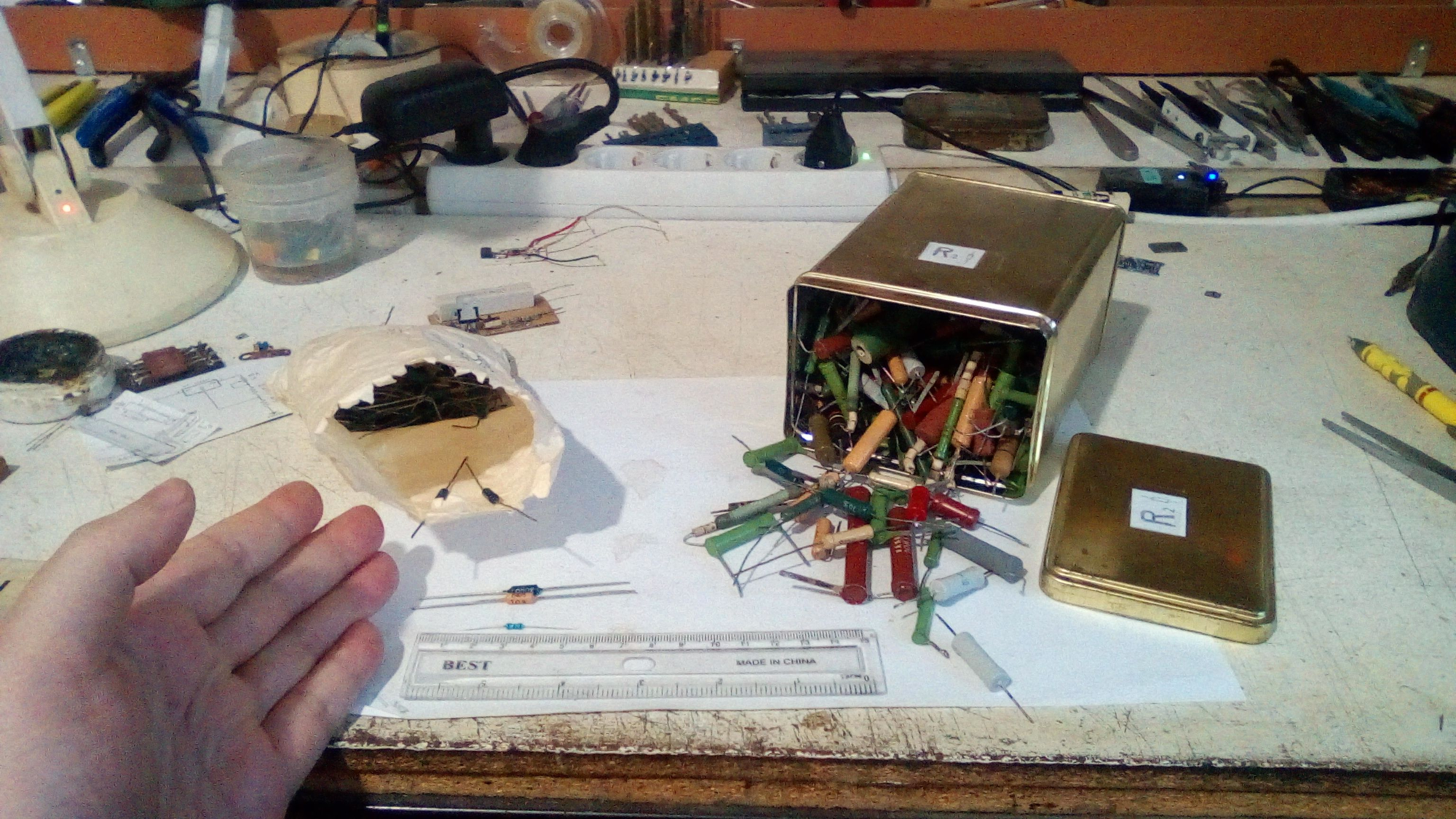

Aham...#2 Just to see the diversity that I have, and to make you forget comparing with the known sizes and shapes of existing commercial ones :
The very small ones, down in the -center- bottom of the image, that have long and sexi legs, are the known value, size and shape, they are the commercial ones. They are 1/4W (250mW). I leave them there for comparison. I also leave my finger there for reference, and a rule with both cm and inch scale. The rule is 6 inch long for my american friends (or 15cm for the rest of the world).
Aham...#3 To be clear, the large majority of my power resistors I have, are marked. But I have some BLACK sheep there, unmarked, unusual shape and size, different brand if you will, different construction time and original country. So I cant compare them with the rest. These black sheep I have my eye on them for a very long time, decades even. And these are the big power resistors. The small ones are not so diverse but I have some romanian brands, a lot of them actually, that also they are unmarked. I assume they are 1/4W and I treat them as such for a very long time. But they are 2 times bigger than the 1/4 ones I have in the picture. I assume the way they build them was ancient technology compared with these new commercial ones.
Aham...#4
The context: ...how many I have... not THAT many, right? But boy they are from everywhere there. And some are brand new !
You see those on the left side? near my hand? Those are the small ones, romanian brand. is my best guess really. They may be polish or russian for what I know. But I know I have a lot of them. And like I said, they may be 1/4W. like the small blue one near the ruler. I suspect they are 1/4 because ancient technology used back then in the 40's/50's/60/70/80/90's when they were made.

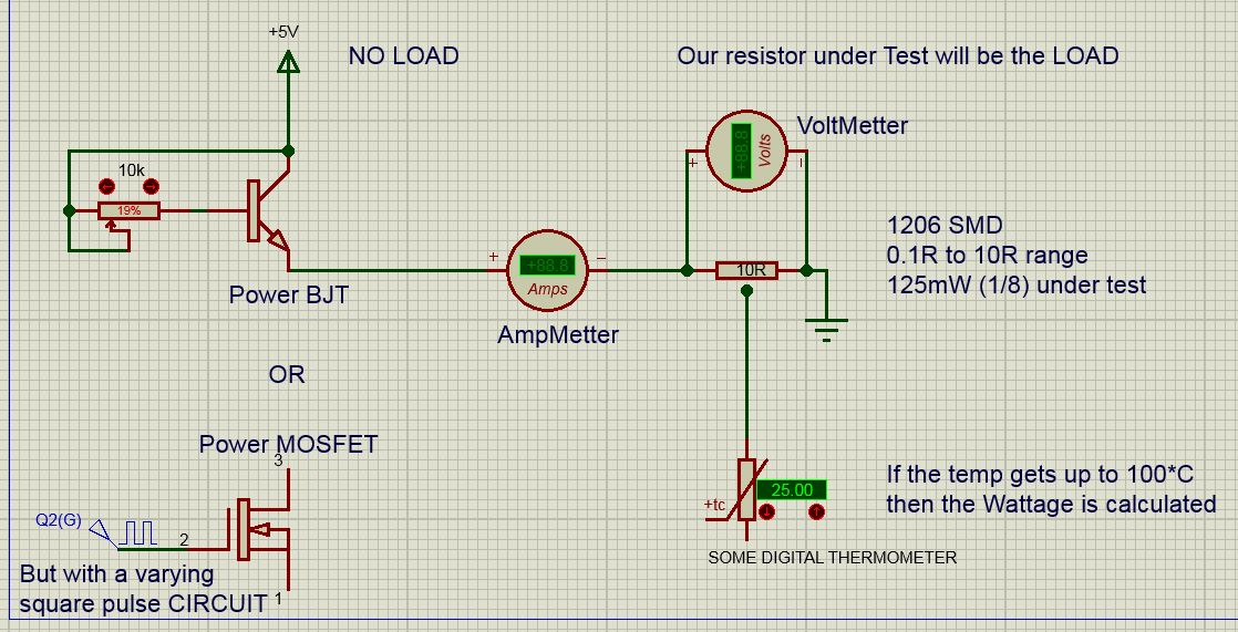

Here is how I imagine the actual circuit should look like:
Only for a specific range of resistors. In this case from 0.1R to 10R.

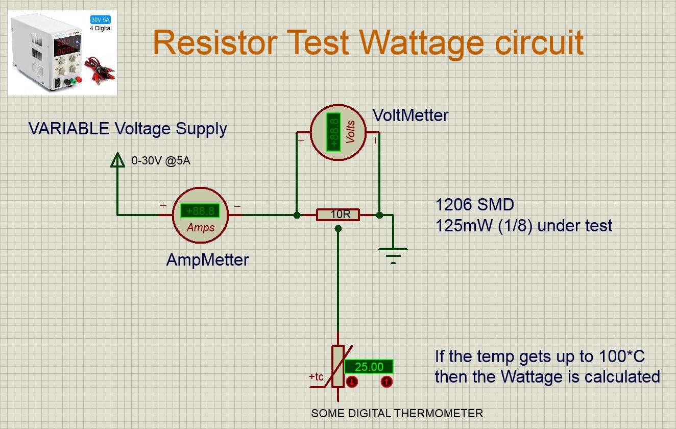

I couldn't sleep. The more I think the more I realize its much more simpler.
I strongly believe the absolute necessary components to measure a resistor Wattage is down to 3 esential elements in the circuit:
1 - a variable voltage supply; 2- the test resistor itself; 3- a measuring tool of some kind.
Actually there are 2 or 3 measuring tools we need: the Ampmeter, Voltmeter and Thermometer. So 5 components for the final and complete circuit.
Here is a more refined idea that I imagined:
Also, doen't matter the 'range' of resistors used with this type of circuit.

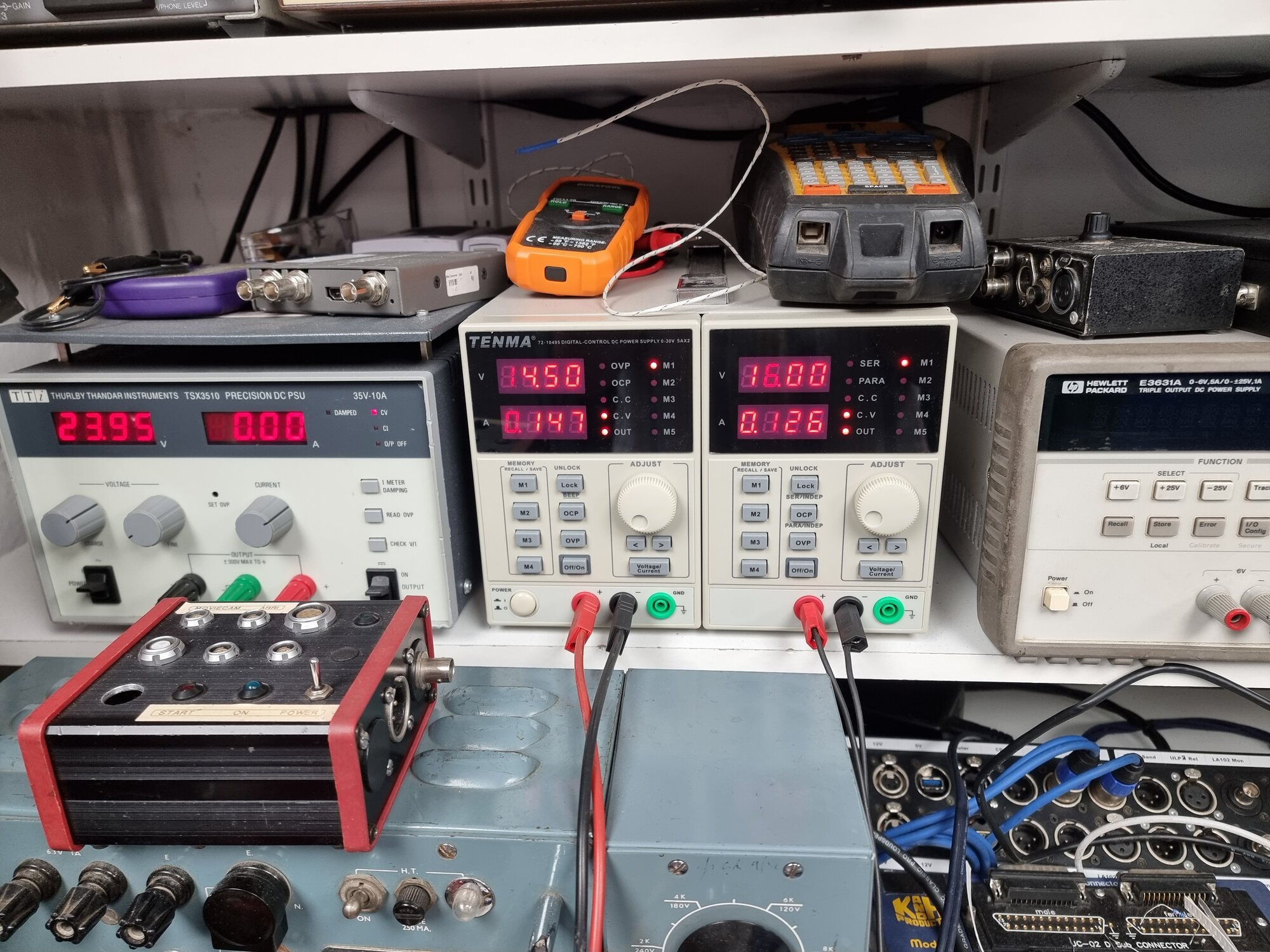

I've done it for you to prove the point: see attached pics.
Resistor A / left PSU: 2.13W.
Resistor B / right PSU: 2.02W
Resistor C (not shown) : 2.08W
All three are at 100 +/-2 °C
From those figures, tell me which resistor is rated at 1W, which at 2W and which at 3W?

It's what I've been saying all along - the maximum working temperature.
This depends on the type of materials used and the quality and method of construction of that particular resistor. For example, a silicone-coated wirewound will typically withstand 250°C or even 300° with no problems, but a carbon composition might fail rapidly at 120°. And with encased resistors there can be significant thermal resistance from the element to the dissipative surface, so the critical temperature (of the element) might be significantly higher than the temperature of the case.
My three samples all achieved nearly the same dissipation at the same temperature, meaning that they all have nearly the same thermal resistance from case to ambient. That is to be expected, because they are all the same size with similar radiation characteristics. The ambient temp was 18°C so the thermal resistance of all of them is about (100-18)/2 = 41°C/W. This gives the gradient of the line in the derating graph while the max temp gives its X-intercept.
The 1W was resistor C, a ceramic-cased carbon composition made in the 1960s. It's working temperature is limited by the tendency of the slug material to change in characteristics. Above its rated temperature, it will tend to drift badly out of tolerance, both reversibly with temperature change and permanently, and have a shortened life. At 2W it started oozing wax.
The 2W was resistor A, a carbon film type. These are more stable and can work at a higher temperature,. If overrun, the first thing to burn is usually the paint, even while the element stays in tolerance. They are not however as resistant to high pulse dissipations as carbon compositions.
The 3W was resistor B, a metal oxide film type. These have generally better characteristics than carbon-film, lower noise, better tempco and long-term stability, higher working temp. This one would probably withstand 6W or even 9W, 3x its rated dissipation, for a short time (its life span might be reduced) although the coloured bands would burn off. At that power, if mounted on a PCB it would scorch the PCB and the leads would desolder themselves but the resistor would survive. In the 1970s there were wirewound resistors in TVs with a thermal cutout that worked by desoldering a spring-loaded contact if the resistor overheated due to a fault in the line output stage.
So there you have it - you need at least two parameters to determine the rating (at a given ambient temperature):
  • Thermal resistance to ambient (which we find out with the heating test but all similar case sizes will have similar thermal resistances.
  • Maximum working temperature (which comes from manufacturer data or comparison with other resistors of similar construction)
