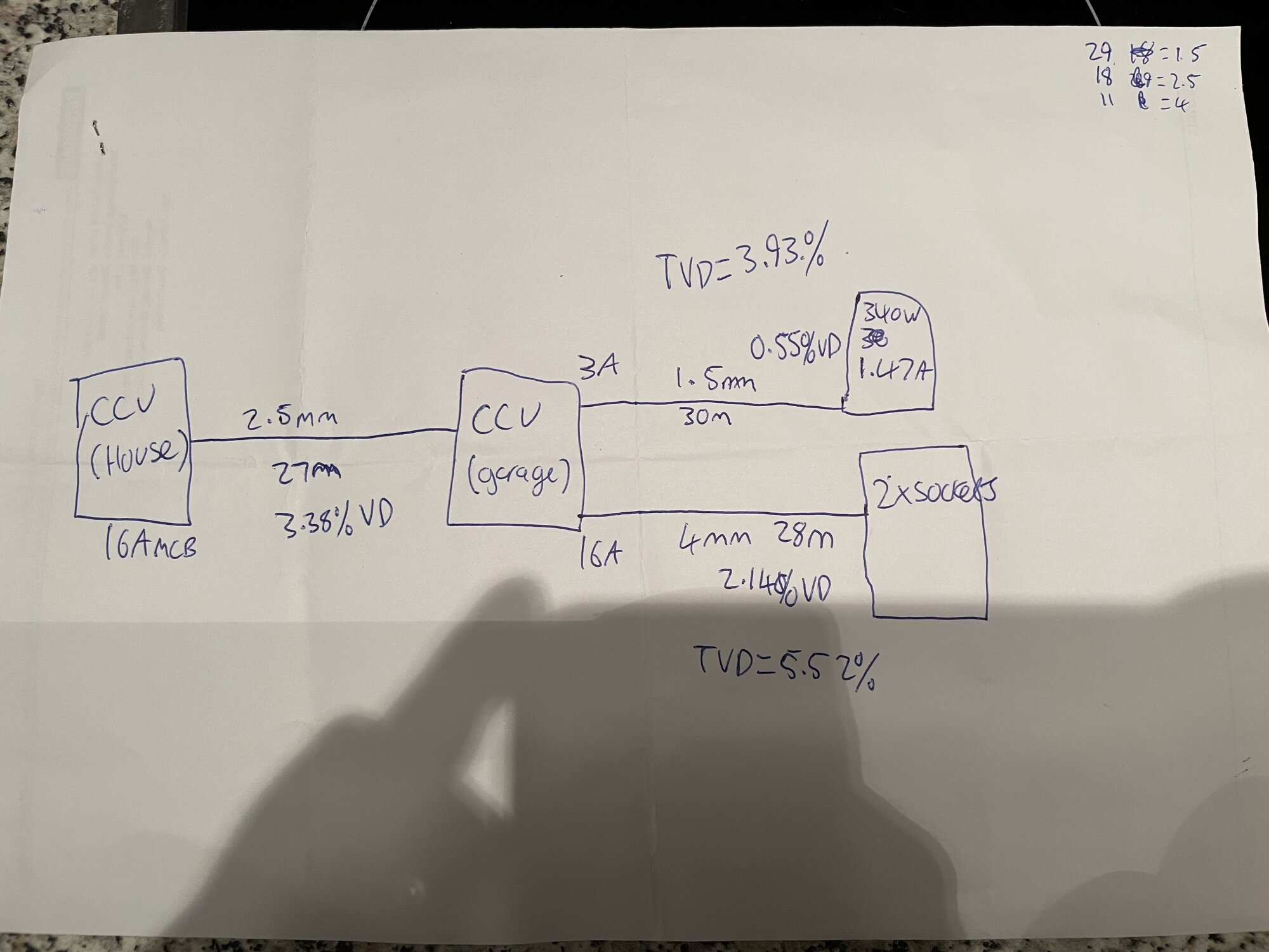

So I understand that this is not ideal before people jump in, but I am stuck with a 2.5mm feed to the garage.
2.5mm feeding garage 27m
1.5mm in garage for lights 30m
4mm in garage feeding sockets 28m
16A mcb in house CCU feeing garage
16A mcb in garage feeding sockets
3A mcb in garage feeding lights
Volt drop to garage = 3.38%
Total volt drop for lights = 3.93%
Total volt drop for sockets = 5.52%
This seem acceptable?

It doesn't comply. Your volt drop is calculated from source not individual parts of the circuit so from your calculations, I haven't done it your power circuit has a drop of 5.52% which is above 5% for a power circuit.
If you want to have the socket VD comply, consider either a larger cable for the socket circuit in the garage (6mm2) (or an RFC in the 4mm2).
However, if you have two B16 MCBs in series, it is going to be pot luck which one trips first on overload. It might be better to have a design e.g. with a B20 for the distribution circuit from the house, and a B16 in the garage for the sockets. Assuming of course that the cable installation method allows this.

Sticking a 13A FCU inline for all sockets still leaves it just over 5% so doesn't help.
Going up to 6mm for the sockets circuit leaves it at 4.8%
Changing to a B10 breaker in the garage leaves it at 4.7%, but obviously could affect intended usage.
If it's left alone but 8m of cable can be lost and sockets moved accordingly then it becomes 4.9%.

I've put the numbers into my VD spreadsheet. I'm getting 1.3V drop for lights, 4.9V for sockets, and 7.6V for distribution. Assuming method C, those can be corrected to 1.1V, 4.4V, and 6.9V respectively, allowing for them never reaching the full 70 deg operating temp.
Just about meets VD for sockets, but not for lighting. I would still install it though, real world it aint going to be a problem.

So the way that I’ve look at is as such. I cannot change the 2.5mm feed to the garage, it’s set, buried. I was going to leave a 16A feeding the garage from the house so that it does not draw more than this. The lights are obviously set at drawing a max 1.47A, the sockets could technically draw 16A, but I doubt ever will. Thinking like using a vacuum for a car, trickle charger for battery and maybe the occasional grinder/drill.
I’ve calculated VD using 70C tables. 3.93% for lights. 5.52% for power, but only using a 4mm. A 2.5 for power would make total VD 6.85% which is obviously too high. But it seems that people this both power and lights are still too high, but why? It doesn’t exceed 3% and 5% respectively, just decimal places, is this not acceptable?
Don't worry about it the volt drop is based on full load which is not likely to happen.
Realistically, what load(s) are going to be used?
If it is a ghetto blaster and occasionally a 2kW heater then check the VD for that 9A load!
But do check the end of circuit Zs is good enough for the 16B MCB, that is a bit more important for safety.
