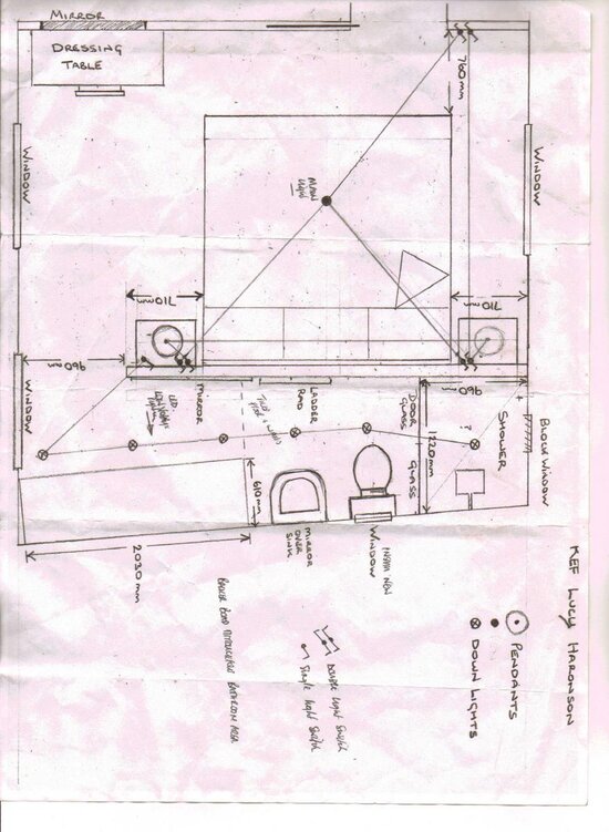

Is there any one out there n sparky world can draw me a wiring diagram for the following. You can see the drawing that n entering the main door top of the stairs, on the left will be two double switches one will be able to turn on the main light, with the option to be able to turn on/off from the bedside as well. The other double switch again to be able to turn on/off the beside lighting.
I hope someone can help?

yes. i can see the need for 3 way switching for the main light, but not for the bedside ones.

Looks like two sets of mutli-way switching controlling both the main light and bedside lighting from three positions ..... but no automatic switching control for the oil dispensers !

I am a electrical panel engineer so me doing the work is not an issue all want is a simple diagram of how to run the wiring, and I want to be able to turn the lights on and of fro the bedside, as my brother is now bed ridden following drunk driver hitting him, leaving him unable to ever walk. This way he can control the room lighting. So "it is nothing kinky" as some has said?

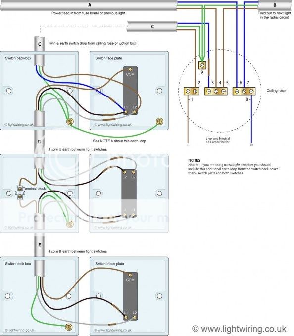

Glynn, firstly sorry to hear about your brothers situation, life can be a cruel place. Regarding the wiring of the circuit Tazz as already posted the diagram you need to carry out the job in post 2.
If after reading the diagram you are still unsure of how to do it then I would seriously consider getting a local electrician in to do it for you,you could even help him with the labouring side of the job to keep the cost down. It is better to be safe than sorry mate.

Tazz has given you a drawing fella, just follow that, sorry to hear about your brother.

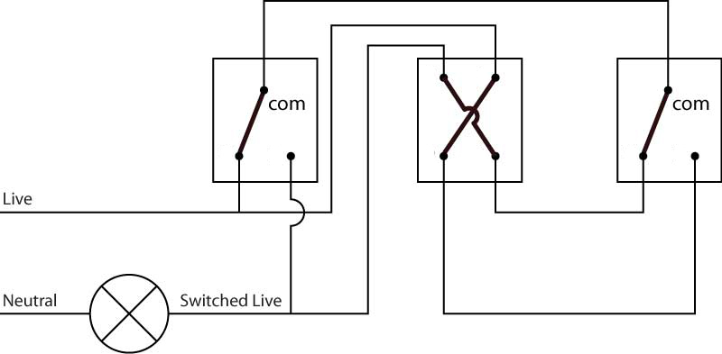

here is a clear diagram showing 3 way switching hope it helps
