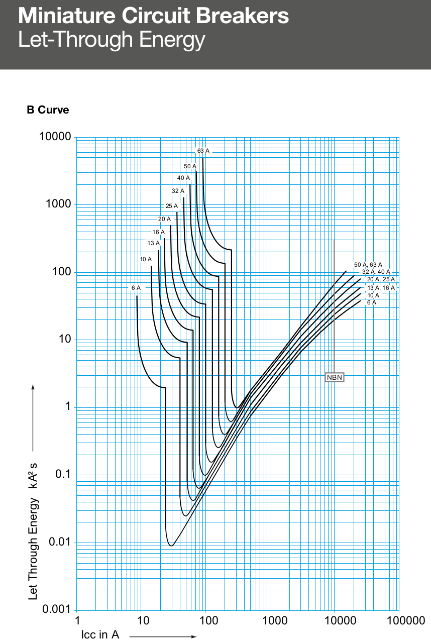

If you check the selectivity tables for the Hager MCBs then for their NBN 32A model and a 63A BS88 fuse the limit is 1.3kA fault current. So if the PFC is below that, the MCB trips, if it is above that then the fuse (probably) also goes.
Basically MCB contact can only open so fast, and while there is a slight reduction in opening time as the fault current goes up, it does not change that much over the range that the 'instant' trip goes. So as the PFC goes up, so the let-through energy also increases and once it gets beyond the pre-arcing value for the fuse it is basically a goner as the wire has melted.
1.3kA is high for an end of circuit value, but not usually high if the supply has a low Ze and the cable short.
Example of MCB let-through energy (grey line at 10kA is limit for that model):
