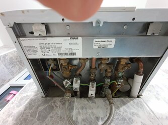

Ive also taken the bottom cover off of the boiler and taken a pic of the bonding - there is a 16mm cable coming into the boiler and from that there is 6mm cable spanning across the 5 pipes is this what is commonly referred to as cross bonding to boiler ? (it looks like somewhere along the way ive lost a couple of tags which i should replace)
The big cable could be 10mm or 16mm and should be to the main earth terminal. The regulations normally specify this as close to the entry point after the gas meter as practical and before and T-branches, so it is possible this was deemed the easiest place to bond it.
The other bonding is typically done, though with a metal boiler somewhat superfluous!
However, the way the T&E cable is joined it no (presumably) supply the boiler on the left is appalling! No cable support and no box covering the terminals.
