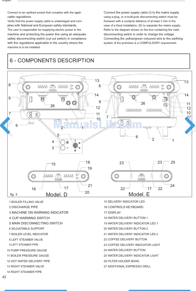

Hi everyone I have started a new venture as a coffee shop owner and have gone out and bought my machine . Unknown to me the shop unit is not kitted out for three phase . I told the owner of the shop and he said he is at his max and just use a 32 amp socket . This is riddles to me and I don’t know what it means . I have attached a file with specifics on the machine . And I wonder can a transformer or something be used . Any response is appreciated

All the individual components in the machine seem to be 240V, and I suspect the choice between a single and 3 phase connection can be made when wiring it up. Such details should be in the installation manual.
If you've got the 3 chrome unit model, running it from 240V will consume about 25 Amps, so you will need the suggested plug and socket, or have it wired permanently into a cooker style connection unit.

So have just come across the same machine on a Google search and it can run only on a 32amp power supply or three phase . So that leads me to my next question . If owner of the building has told me he is at his max with power supply and there is only three pin sockets in the unit , what can I do ?
This would appear to confirm the machine can run on a single phase 32A supply.
In the OP you stated the shop's owner told you to use a 32A socket, which would seem to be sound advice. A 32A socket is a 3 pin socket, but of a different type to the 13A sockets you would be familiar with.
