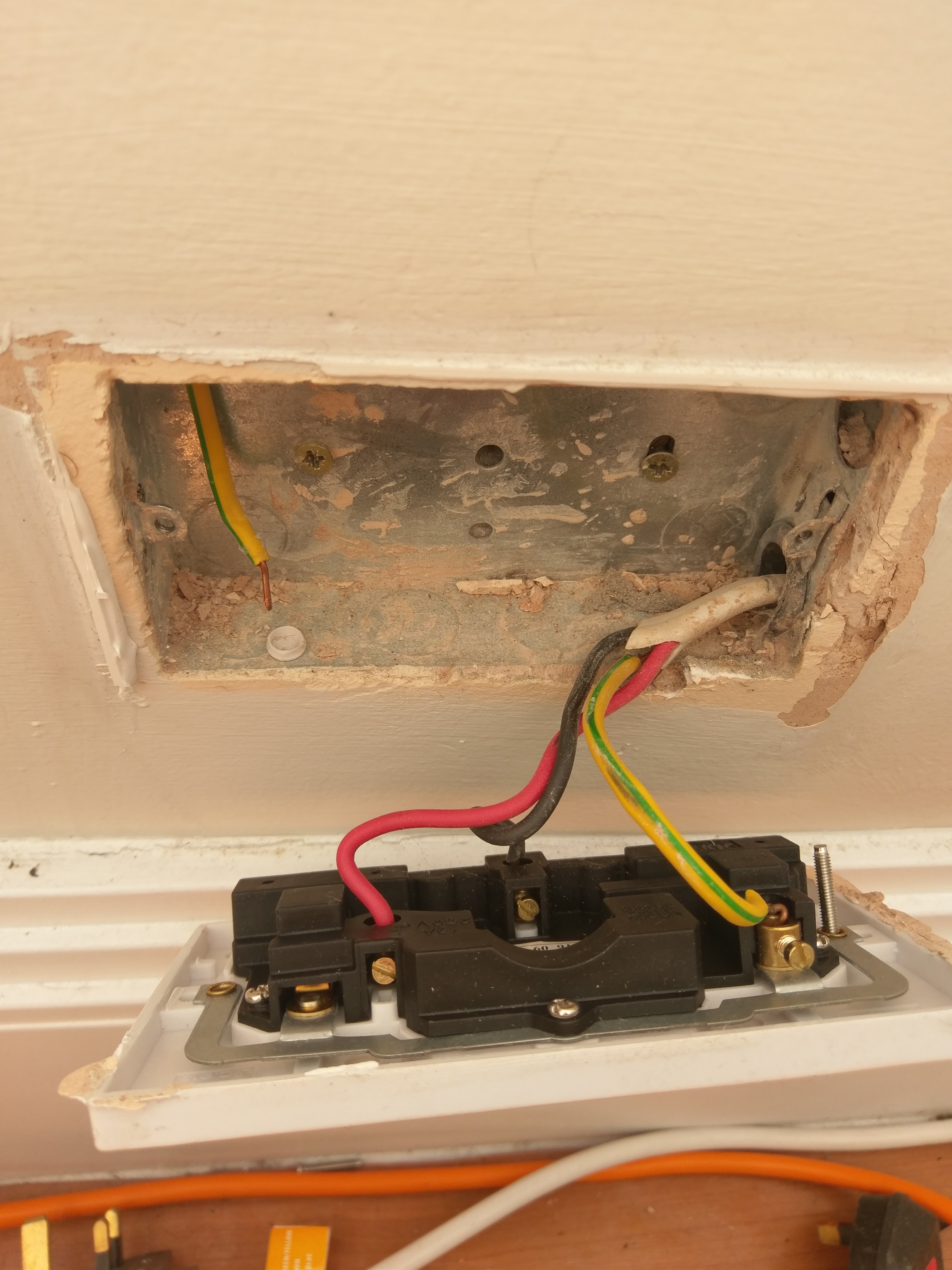

Hi. Yesterday I got electrocuted when getting out of one of those inflatable Lay-Z Spas and had to go to hospital. I am fine, thank goodness, but I am now trying to address this with Bestway who manufacture these products. They asked me to take photos of the set up I had (plugged directly in to a mains socket, as they advise) and said that they will need to test the socket, so it got me thinking...I fed the lead in to my kitchen and plugged it in to one of the sockets there and there was no indication of voltage in the water when I used my voltstick. When I plugged it back in to my conservatory socket where it had always been however, the voltstick lit up! I have recently moved in to my house and now that I have been here a few months I have started to realise that the painter/decorator who lived here before fancied himself as a bit of a jack-of-all-trades. I think he built the conservatory himself and now also think he wired it himself, as that socket causes my spa water to be electrified!
Where I am more confused though, is that Bestway state that their spas have built-in RCDs that will cut power in the event that water becomes electrified and also if there is some sort of power fault. So even though I seem to have a faulty socket, should the RCD still have prevented the water electrocuting me? I just wanted some professional advice before taking this further, as I can see them trying to use the socket fault as a way to wriggle out of responsibility, or maybe they would be justified in doing so? I just have no idea - any insight is greatly appreciated.

hi, i have a similar spa. it has a RCD built into the lead. if you look, about a few inches from the plug ( the main one, not the elv for the lights) there's a big black lump. it's a 10mA RCD. with the lead plugged in ( to your kitchen) press the test button on the lump. it should trip. in theory, this RCD should prevent any shock levels that could cause injury. however, my take would be that you have fauly wiring in the conservatory, and you 1st call should be to get an electrician to investigate. whereabouts are you. 1 of us may be close.
Bearing in mind your comments about the electrical wiring in the house, I would get an electrician in to some testing using appropriate equipment. It does sound like something is amiss, and the shock you have already had proves that this testing needs to be done urgently.
Thanks for the fast replies. I am especially keen on the Mother-in-Law suggestion! I unscrewed the faceplate and this is what I saw. There is an earth connected to the socket by the looks of it, but then another loose earth on the left - does that suggest that what they are saying about relying on the property's earthing means it isn't their fault?
Looks like short wire is the flylead which connects the metal back box to the earth on the face plate. Does it look like it's been cut? I only ask as it looks a bit short.
You still need to get an electrician in to do some testing though.
the fly lead to the back box was once obligatory, but now optional. should not affect safety. the problem may be upstream of that socket. as requested previous post you location.

  • Doesn't look like its been cut at all.

From your last post, am I right in thinking you received this shock when you got out of the SPA ?
What i mean was when you got shocked was one part of your body touching the water the other directly touching the ground (wet foot on grass) ?
Its very important that you arrange a qualified electricain to test this for you.
If you found the earth cable from the backbox loose inside there when you opened it, then it is possible that it could have made contact with the live terminal when it was all squashed in. If the other end of the earth connected to the socket front isnt properly connected, then it is possible the backbox became live, and then connected to the faceplate earth through the screws, which in turn could have made something in the pump case live if it is class I. This would have made the water live, creating a potential between the water and the ground.
Whilst this sounds unlikely to have that many faults, one of them is clearly visable there, and the other one (lack of earth) is not that uncommon.
Either way, if you recieved a shock serious enough to send you to hospital, and you think the wiring is suspect anyway, you should have it inspected ASAP. It sounds unlilely to be a fault with the spa if the RCD is functioning correctly.
