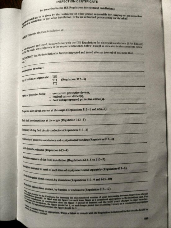

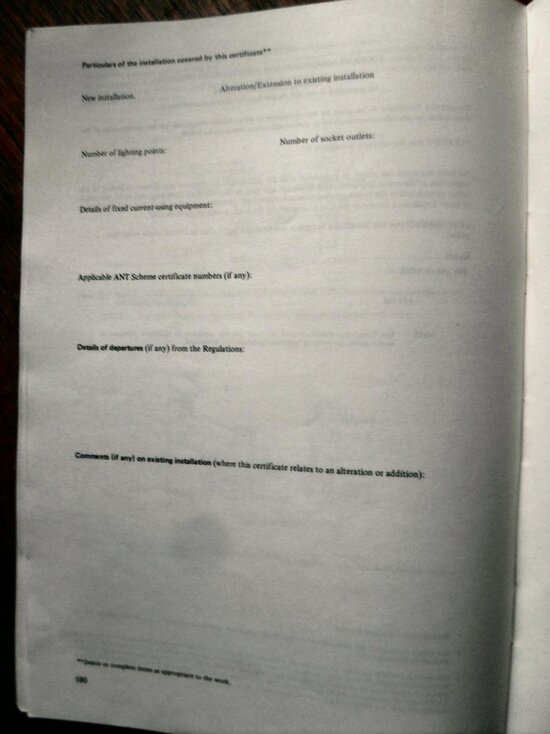

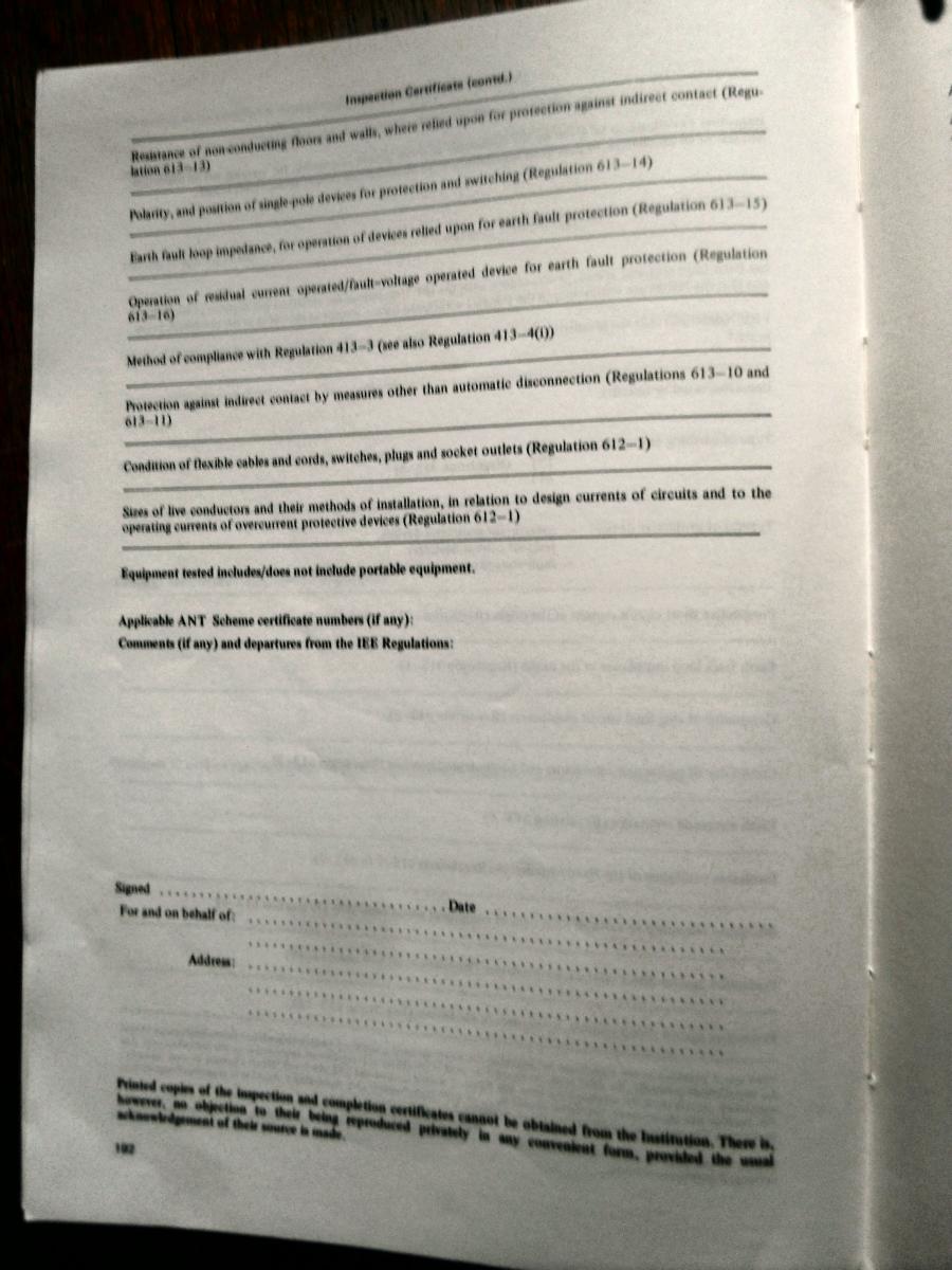

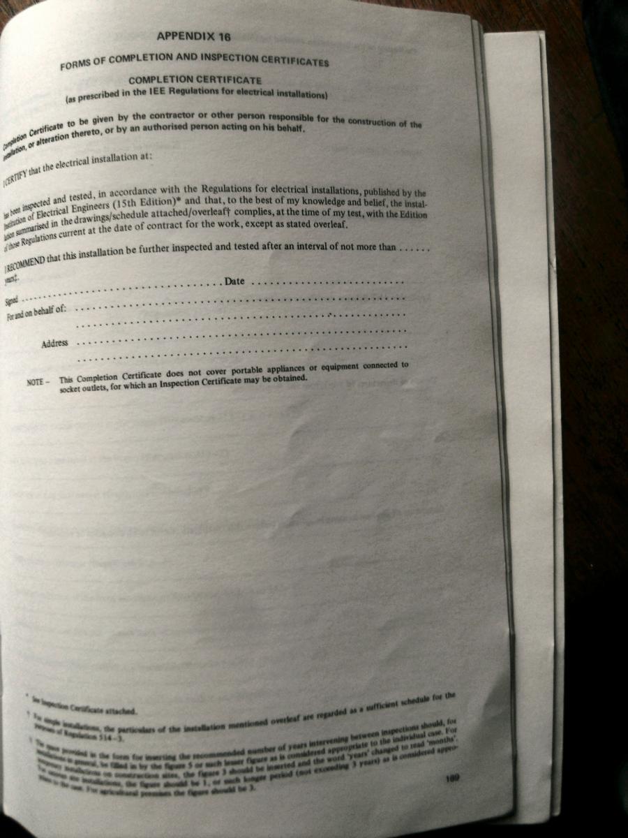

Here are the 15th edition forms from 1981 book :), 2 off inspection/test, and 2 off completion pages, 4 in total
