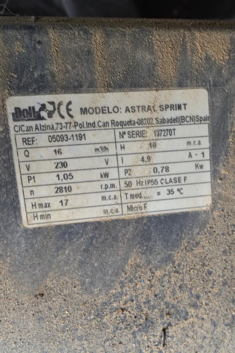

Please could someone explain to me about this motor plate for a pump and why the numbers don't seem to add up, such as why the amps don't correlate with the watts when connected to the nominal voltage. Also what kind and type of protection is needed for the pump. Many thanks.

Hi welcome to the forum, The Kw rating on the plate is not an Electrical value its a mechanical value namely the turning energy available at the shaft, do not convert this direct to electrical power without the correct calculation or you will be scratching your head.
P1= input power. P2= output power.
Input VA = V.I = 230 x 4.9 = 1127VA
Power factor = P1/ input VA = 1050/1127 = 0.93
Efficiency= P2/P1 = 780/1050 = 0.74
As this is a 1hp motor it should be equipped with thermal overload protection, and if hazard could arise from unexpected restarting, zero-volt release.
Well, sort-of. 'I' is the symbol for the quantity 'current' which we measure in units of 'amps', for which the symbol is 'A'. Although it's not laid out well, it does say I 4.9 A.
They've made life very easy with the info on this particular plate, P2 is the power output (mechanical power) and P1 is the power input (electrical power). 'I' is the absolute maximum permitted run current.

what are the H values?
Indeed. The flow rate is 16 cubic metres per hour at a pressure of 10 m.c.a. (metros columna de agua). Power delivered into the water is Q.H.rho.g/3600 = 16x10.1000.9.81/3600 = 436W. Efficiency of the pump itself at 10m head is 436/780 = 0.56.
Yep H is head pressure and m.c.a. is a unit of pressure (meters column of water). 1m.c.a = 0.98 Bar. 1m.c.a = 1.42 PSI. They give the Q=Flow rate that the pump will achieve at 10 meters of head at sea level.
They also give the max head pressure the pump should be run at as being 17 meters and often with a centrifugal or multistage centrifugal pump there's a minimum head pressure requirement as well. Sometimes the minimum head requirement is to prevent electrical overload and sometimes it's to prevent mechanical issues such as impellor lift and cavitation.
