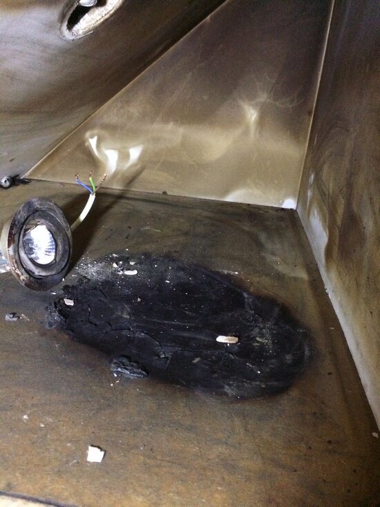

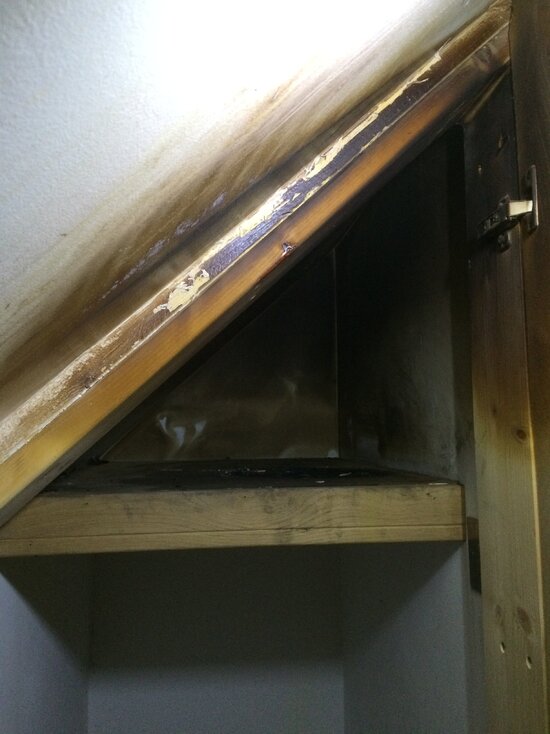

Fire damage from very badly designed install (hhm hhm builder) who fitted a GU10 in a cupboard with an external switch, not a cupboard switch (on/off with the door) no, that would be too sensible. Then proceeded to put a shelf in the cupboard SOOOooo the owner likes putting the gym clothes, spandex and the like, in the top cupboard, closes door light still on but you can't see because door closed - you couldn't make it up. Clothes catch fire - smoke damage and us to isolate and test!
Great for my NVQ though - didn't say that at the scene! image.jpegimage.jpeg image.jpeg
