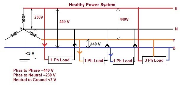

can someone explain the reason why the voltage in a domestic dwelling rises when the neutral is broken out in the street? 3 phase is not something I deal with and not too clear on the theory?! probly a daft question just me being thick?

Ok, I'm on my 5th beer but I'll try lol.3 houses on 3 phases fes by star tranny. Break in suppliers neutral before any of the three houses. Voltage on L1 into first house, returning on neutral which is no longer at 0V, this voltage on the neutral then picked up by next house along and then returning via L2. Voltagfe on L2 into econd house, returning on neutral then picked up by third house returning via L3, third house on l3... Returning via neutral to first house then to L1.I can visualise it quite clearly, explaining it in english is another thing Biff! :DYa get my drift tho?

If you lose the Neutral on an unbalanced star, you get a 'floating neutral'.
The voltage on the neutral will rise wrt Earth (0V) depending on the loads on the 3 legs of the star.
The phase angle between the 3 phases will change as well.
edit...
I could give a link, but it's prohibited!
With a floating neutral the voltage on each phase shifts in relation to the load. In other words the heavily loaded phase the voltage drops, whereas a lightly loaded phase the voltage rises. So if the only load in you’re house is the television and other bits and pieces on stand by and you neighbour turns on the oven. Down goes the voltage in his supply and yours shoots up. In bad cases up to the full Ph to Ph voltage.
So long as the neutral is contiguous the voltage Ph to N and Ph to Ph will remain constant.

Reactions: 5 people
Thank god someone found pictures! Thanks Sintra, much easier to understand than my beer soaked explanation :D

just experienced the fault the first time yesterday afternoon . the suppliers aluminium neutral broke in the street and the voltage rose to well over 400v in a small culdesac causing no end of damage. RCBO's knacked through out the street 12 combi boilers with damaged pcb's and no end of tv's ,sky boxes, washing machines and various other appliances damaged. the insurance assessor from NEDL had his work cut out.

Tony's explanation makes a lot of sense (thank you). I think it also explains a fault I was called to in a hotel kitchen, where they had a 3-phase distribution board which, for want of a better phrase, went mental - all the fluorescent lights were flashing and wouldn't strike, appliances didn't work, RCBO's were clicking away like a load of drugged-up click-beetles at a rave.
Testing the voltages on all the phases gave very odd readings: Red: ~180v, Yellow: ~230, Blue: ~300v! Odder still (at the time), switching an industrial toaster ON, made the flickering lights settle down and come on, and some other appliances started to work as normal. As an apprentice with no practical experience of 3-phase I admitted defeat and got someone else in to look at it, and they ended up changing the grey Wylex 3ph trip for a new one.
My theory was that the insulation in the 3ph trip was somehow breaking down letting voltage creep across the phases.
Now I read this about floating neutrals causing the voltage to vary with load I think a broken/bad neutral may have been our problem - explaining why switching the toaster ON brought the voltage up closer to 240v on the red phase making the lights and stuff work again. Sadly most of the things on the blue phase didn't pull through, God rest their souls...

This is NOT particularly a "3-phase" problem.
Some places use single-phase center-tapped, and we have the same problem.
One circuit needs two wires.
But you can do two circuits on three wires, three circuits on four wires. This can save a lot of costly copper.
US, Canada, and others use 120V lamps but usually delivered as 240V 1-phase, center-tapped to give two 120V circuits on three wires (and also a 240V connection for cooker).
When the Neutral comes loose, all heck can break loose.
I set up an audio mixer in a college lounge for a concert. There was some problem but then it worked. Worked really well. About 20 minutes later BOOM! and a lovely 1m wide mushroom cloud of smoke from the mixer. Meanwhile a coffee-maker in the adjacent office wasn't getting hot.
Immediately after the event I measured 170V at my "120V" outlet, but as we will see this will vary.
College electrician was called and found a bad Neutral joint in the fusebox. (Just as in your Pet Peeves thread, low-bidders don't always get ALL the screws TIGHT.)
The drawing shows the approximate conditions.
Office and lounge were fed separate circuits. 120V circuits are staggered over both sides of center-tap for balancing and reduced Neutral current. Office and lounge turned out to be opposite sides of the split.
There was a 1,000+ Watt coffee-maker in the office, my ~~100 Watt audio mixer in the lounge.
With all three wires, each load got nearly 120V. Small drop in line loss.
With-OUT the center-tap Neutral, the big pot and small mixer were in SERIES across the full 240V.
You all know how to derive voltages in a series circuit with known resistances. But I put some numbers on anyway. The mixer is no-way a pure resistance, but I've assumed it is to get a quick answer valid-enough to show the general trend.
In this case the mixer got about 1.8 times the nominal voltage, because its 'resistance' was about 10 times the resistance of the coffee-pot and they were splitting double-voltage. Back in the office the pot was scarcely warm having about 0.2 times what it wanted.
As we see, the lost-center can give more or less than nominal depending what loads are on each side.
