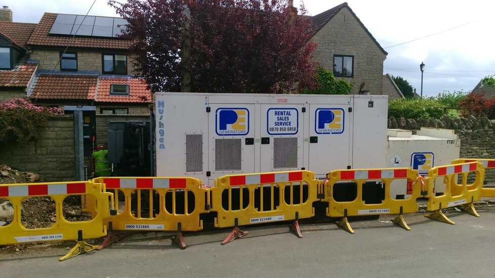

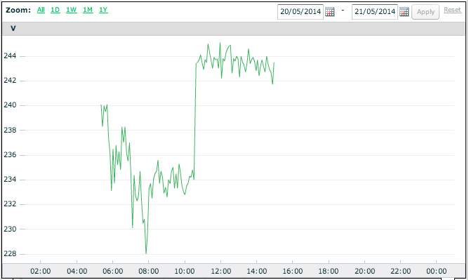

We had noticed that our supply was going to be switched to a generator today. Indeed it happened - this is now installed at the bottom of the street. Can you guess what time it was attached? SolarEdge inverter seems happy enough, although it hasn't been very sunny today.

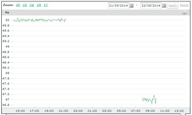

Generator packed in this morning at 06.30. Restarted at around 08.00 but is running at 47Hz! Inverter won't start up due to grid under frequency errors.
