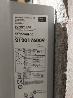

This inverter looks like it has just one MPPT, that means both strings need to be identical, hence not surprised connecting to 2nd string did not work. Not sure from your description how the second panel has actually been connected. I guess the original 8 panels are all in series on string 1, string 2 is not used ? - The new panel i guess is connected in series or parallel with the original 8 in string one ????

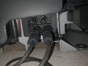

Thank you very much for your reply, really appreciated. On the bottom of the inverter there are two more plugs/slots (-ve and +ve) as per the photo for the 2nd string?
Or just because there are available connectors there maybe it means that my 9yr old inverter doesn't have a second MTTP internally, is that how it works perhaps?
Original 8 are connected in series (I think as one goes in shade early evening all generation drops significantly), end cable goes into an isolator and then into the inverter. So yes, I presume that this is the string 1.
The new single panel has its own separate cable, and the intention was it just to connect it into the available slot for the 2nd string in the inverter (as per photo). Once connected the inverter didn't want to know, didn't want to power up having both strings connected.
Strange how it doesn't perform well on the low light and then full capacity when much brighter either on a brightish cloudy day and when really sunny?

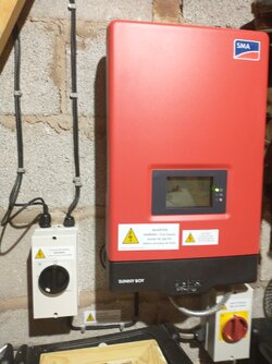

New (panel) cable (left one on the photo) then goes into the existing isolator (with black dial switch) where it joins the cable from the 8 panels (right one), and then the single feed goes into the inverter. So the isolator is the only place where both connections meet, and then single cable from there into the inverter. I really don't know would that make a series or parallel connection then? Is that the issue you would think?
This is the feed from the isolator box. Those two empty plugs were presumed to be used for a 2nd string initially from the new panel. When plugged no reading/input was registered at all. And then that second option was implemented (join the feed via existing isolator).
I hope this makes sense, and once again thank you very much for your assistance. Please feel free to private message me your number if easier to explain that way.
By process of elimination i think i can make some assumptions as to what has happened. That inverter is designed for a maximum of 2000W output. You now have 2400W of panels connected, so on Sunny days expect the inverter to take evasive action to limit damage to its components. This inverter states a maximum of 2100W from the panels so if you are seeing dead on 2000W of output chances are that the inverter is limiting the DC input from the panels, no biggy but just bare in mind.
Next is the Inverter strings, the reason for the extra two plugs is to allow for a second string. SMA and all inverters i have seen are very specific how panels should be connected, as you have 2000W on string 1, i cannot see a scenario where you could use string 2, it is in effect redundant. This is pretty standard so i am surprised the electrician thought he could connect one panel to it..... this does not make sense.
Aha, ok I understand this. Yes, I am seeing it dead on 2000w now remaining constant on the sunny days, while before it would be in the region of 1600w or there abouts, sometime lower on the hot days. I understand also that due to the inverter capacity/limitation i am loosing some from the new panel.
So, as the inverter is capped/limited to 2000w, each string should be equally split in essence (1000w each) to work properly. So inverter recognises that there's already a string with 2000w connection and shuts off the second string, and therefore I can't plug this additional panel then? Say for example that I had 1600w existing system on 1string and then plugged new 400w panel to the 2nd string, would the inverter, accept that? Am I understanding it correctly. Not sure why he thought that was a possibility with the current setup (2000w + 400w)?
So now we are back to the Optimiser, you have not offered any specs to this unit so i am guessing. I suspect its still a series connection but imagine having an optimiser in the inverter and one on a panel. I can imagine some "arguments" going on between them, lol
Sorry I don't have any details on this, just that the optimiser was installed on the back of the panel (panel cable into the optimiser and then cable from the optimiser up to the roof joining into the isolator meeting with the cable from the existing panels and then into the inverter.

Strings should be balanced and achieve minimum voltage to turn on, plus you have just one MPPT. One panel will do nothing but drag the rest down. You have 8 panels and you need a minimum of 220V to turn on the inverter you are already at around 8 panels just to get the thing started. Hence i cannot see how string two could be used, its possible i suppose it allows for 16 X140W panels but they would need to have the same Sun action to work efficiently
I am equally baffled. I would not even attempted what you have done without Sunnyboy underwriting the design as the extra panel induces a change of electrical characteristics in the main string which the MPPT will have to deal with, also of course the optimiser also needs to get some light to turn on as such i could not predict what would happen at start up.
