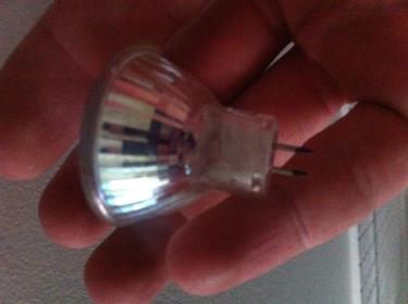

I have some of these lights

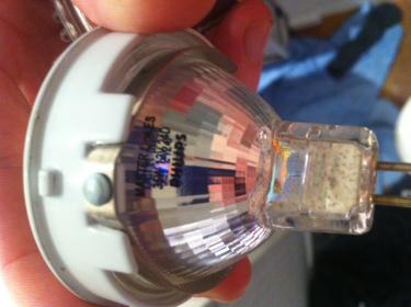

And some of these
And I want to replace them with Some MR11 and MR16 LED's .

you currently have 12v halogen spotlights, you need to alter exhistiing wiring to suit LED lamps.
also your dimmer may not work with LED dimmable lamps cause the dimmer will have a minimum load rating.

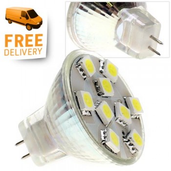

TopCat has posted a lamp above the pins on the lamp are different to the 12v lamps you have.(thanks TC)
so something like this or what ever will work ...
[h=2]INFORMATION[/h]
Lumens120lmBeam Angle120
Power Consumption1.8wCE & RoHS CertifiedYes
Input Power12VSize35mmx37mm
WattageNoEquivalent To9w
Average Life in Hrs50000Voltage12v
BaseMR11Dimmable (Option)No
Bulb TypeLEDColourCool and Warm
im happy to get the dimmer switch removed and just have off and on ...... still dont know if it'll work. Theres about 4 lamps in each room and each one has the same setup on it
My advice, to keep things simple and cost effective would be to replace the MR16 lamps with LED MR16 and remove the dimmer switch and replace with standard on/off switch. You can get MR16 lamps that run straight of 12v electronic 12v transformers, I get them from a company and they work well, nice and bright(not sure if I can name the company here though)!!!!
