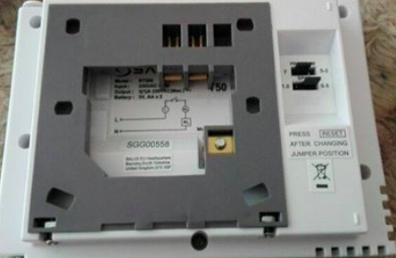

I currently have a manual thermostat (Picture 1) and I wanna fix a digital one.
The letter on the wires are different and I am not sure how to connect the new one properly.
Any advice?
Thank you

Two wires, on the existing stat com and N/O. Connect to the two terminals on the new stat either way round. Safely terminate any other wires in a connector and connect the earth to the earth terminal on the new stat which will just be a 'parking terminal'.

What stat do you have currently and what do you want to replace it with? I assume both low voltage on off types.

To me, it looks like you only have the switch wire there, live in and live out. Most people don’t realise you also need a neutral for most stats to work properly. Looking at your new unit, it looks like the wiring diagram is showing you need a live and neutral for it to work, I could be wrong though. If it’s just a switch wire required. You need to find out witch one is the feed. And to do that you will need to turn the power on and test witch one becomes live. That would be your “In” and the dead cable would be your “out”. But with most digital or RF stats, it doesn’t matter witch way round they go. One thing you do need to know, if it’s digital, what’s going to power the stat up? Does it run on batteries? Is it wireless? If not then you will need a 3 core cable running in for it.

The wiring diagram on the stat shows a neutral to the load and only a switch pair connected to the stat.

Well I hope the advise I’ve given him helps. As I’m sure your awear, there could be a possibility he could damage his new digital stat if the wiring is incorrect.
