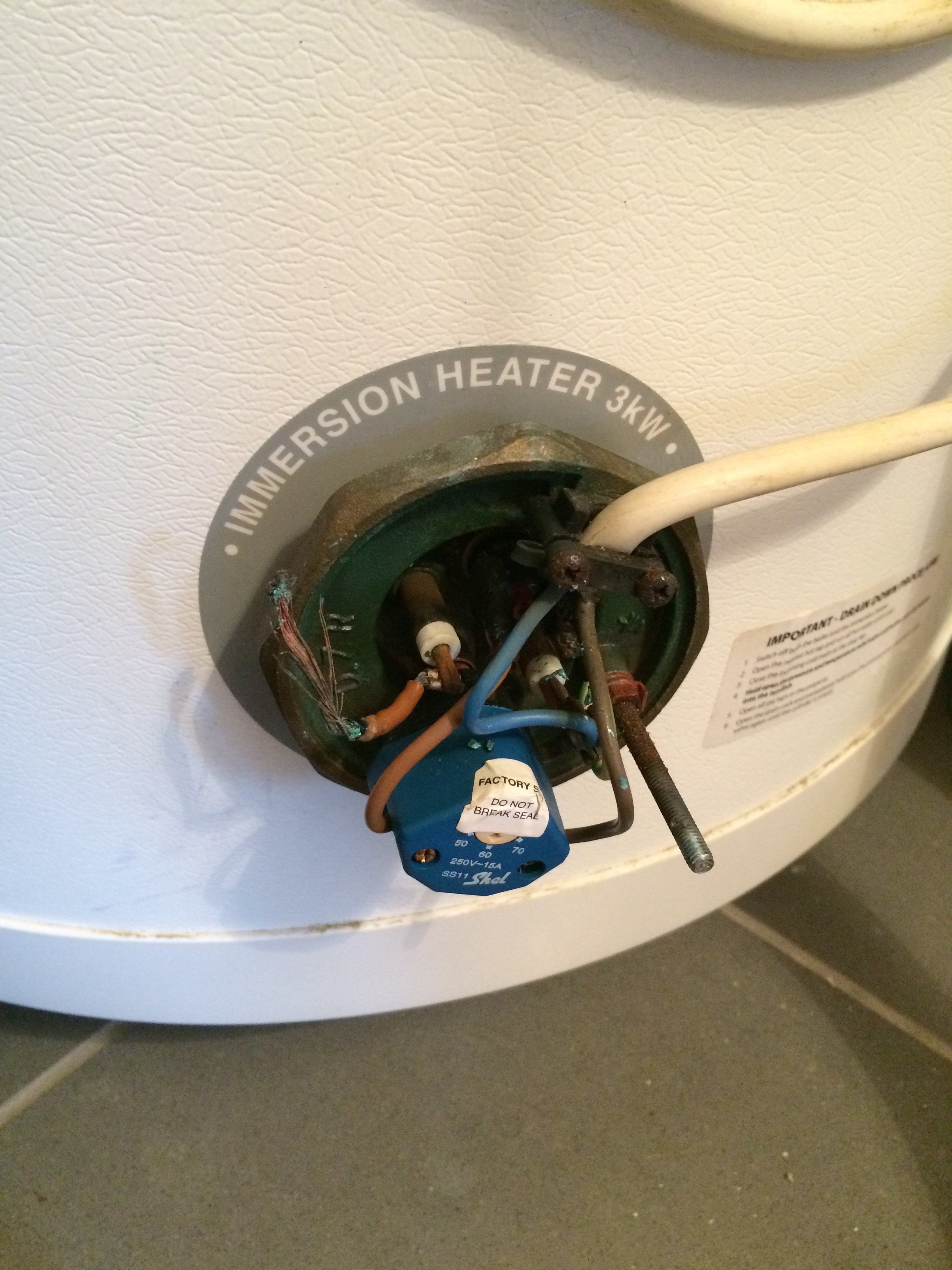

Recently I attended a faulty economy 7 immersion on an unvented cylinder. The live had completely come away from the element, either by burning out or someone interfering with it, surprisingly the electrics hadn't tripped and there was signs of scorching inside the immersion cover.

I'm sure you'll get plenty of help here, and there's several interesting questions you've raised. Re the L disconnected from the element - if it had touched E or N then one or both of the protective devices should've tripped. Any signs of overheating?

This is the immersion I mentioned
Ahh yes I see what you mean, its connecting onto one of the element connections. Perhaps someones tried to reconnect it or bodged it connecting a new stat?
To be honest I just took one look at it and said new immersion. I'm pricing one up now, Gledhill Sh010 £60 online.

Looking at the pic, this issue here is water ingress from the tank (possible steam leak when pressured), the screws, threaded bar have all corroded with moisture but the thread top that holds the lid is still shiny that would suggest the nut holding the lid on had not been exposed to the moisture ... you need to figure out why the internal parts are corroded and where the moisture is coming from, I would replace the element and stat and pressure test the tank before using .... as goes the electrical queries then you have had plenty of informative answers :)
