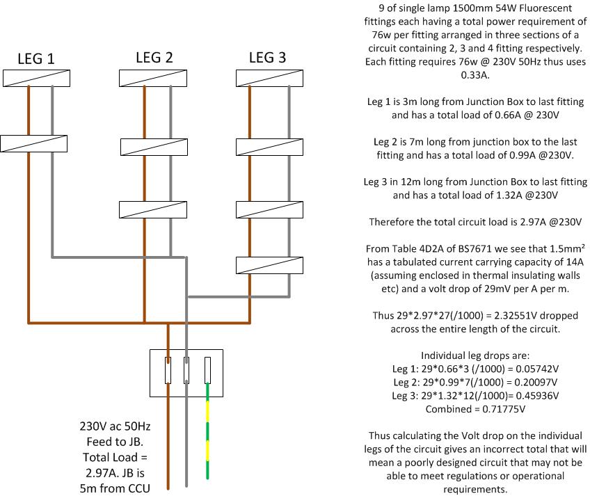

Is this a ruddy wind up or do you simply not see it...Calculating the individual legs of a circuit will give an inaccurate final figure, you need to calculate for the whole circuit...see this I have just knocked up for you..

what software do you use for these drawings? i've got visio and am struugling with it. it's too complex for this type of drawing work.
Tele, I use AutoCad for proper stuff, but this and the others you have seen me post on here are all done in Visio chap. I create them as a drawing, save as a drawing, then save it a second time as a jpg for posting here.
Patience my friend...:D
I was taught that way at college. The reason I'm struggling with this is because not the entire length of the circuit is taking all the load stated. So therefore they must be dropping different voltages across certain lengths. That's why I don't get it. Clearly I've been taught wrong. Sorry to frustrate you.
