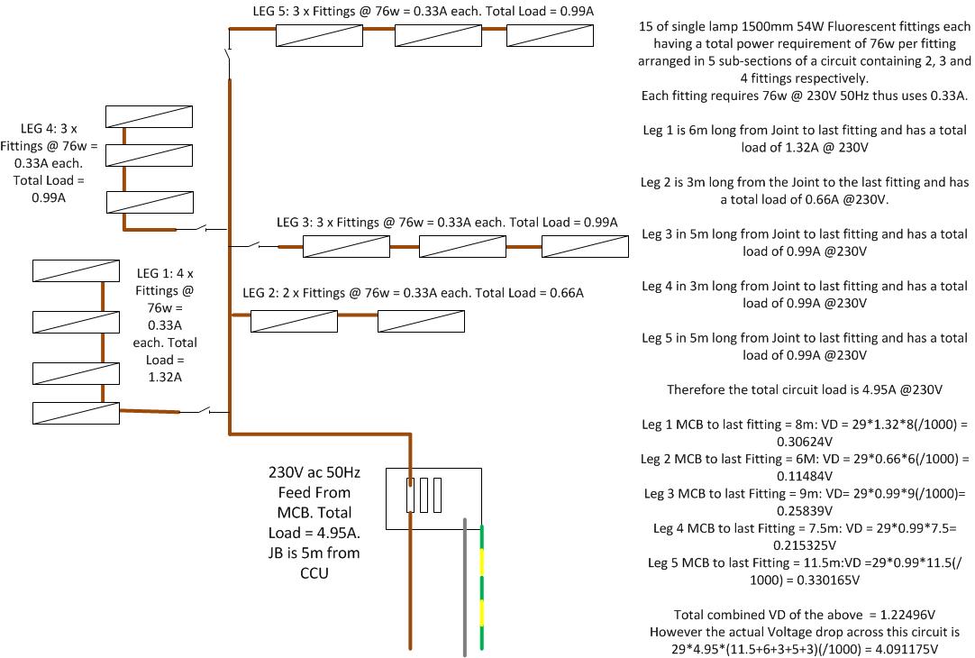

Following on from this discussion with Monkeyblain regarding volt drop in circuits that are not simple straight line circuits I have received a number of PM’s regarding this subject whereby the message has requested further information because they either feel I have explained it wrong, or that they have misunderstood.
Obviously I like to think that over the years I have got this aspect of my job correct, having never had a serious volt drop issue on a cable I think I am certainly doing something right, but I am loathe to imply or state others are wrong, just that perhaps the way they are thinking about this problem needs tweaking or perhaps they have simply been steered down the wrong road in the past.
I believe there is a misconception of the impact that Volt drop can have, and how it actually operates in practice in a given circuit, but it can have a radical and critical impact on the efficient and the safe operation of circuit, the classic lights going out on a 110V site temporary supply when the 9” Angle grinder starts is an extreme example of this, one that should never be seen on permanent services.
We all know that on a simple circuit, calculating the volt drop is a simple matter; See Fig 1 below:
Figure 1: Simple Lighting circuit
Now we can see this is a typical type of lighting circuit, nothing complicated but branched into two sections from the first switch as a two plated system in conduit (for arguments sake).
Assuming that all lights are on at the same time we can calculate the voltage dropped along the length of the circuit thus:
Total length of cable: 7.25m +8m +12m+7m = 34.25m
Total load on the circuit = (500W*2) + (92W*4) = 1368W or 5.95A @ 230V
The circuit has cables that pass through and buried in insulating walls, so from Table 4D2 of BS7671 we can see the volt drop of 1.5mm² is 29mV per Ampere per meter, thus:
29 * 5.95 * 34.25
1000
= 5.909V​

Now we can see that the combined voltage drop of both sections is 1.21V + 1.91V = 3.12V
However our calculations earlier showed us that the total voltage drop across the entire circuit is 5.9V, so why the discrepancy?
Well this a combination of two circuits, that are effectively running in parallel, being combined into one circuit, the increased cable length of the circuit and the combined effect on the section of cable that will carry the total load of this circuit causing a heavier impact on the voltage drop than the two sections would have individually.
I know that many might think that “surely we can treat these as two circuits and only worry about the individual volt drops for each section and simply add them together”, but this would be wrong because you have a common neutral that makes it one circuit, remember, current flows the opposite way to voltage, neutral to positive, and this is the same whether the circuit has a direct or alternating current.

Handy, to some degree I agree with your comments and those of Richard, ....................................................................................................................................................................., but that is for another discussion altogether.

To use the above example of a feed from a CU with spurs off to individual lights. If the supply to the first light branches off at JB1, second at JB2, etc:
For light 1, total VD = VD from CU to JB1 + VD from JB1 to light 1.
For light 2, total VD = VD from CU to JB1 + VD from JB1 to JB2 + VD from JB2 to light 2.
For light 3, total VD = VD from CU to JB1 + VD from JB1 to JB2 + VD from JB2 to JB3 + VD from JB3 to light 3.
and so on.
If the CU is any significant distance from the origin of the installation, add the VD for the submain (at the expected maximum loading) to each distribution value.
The VD in each section of cable is calculated on the mV/A/m, actual current and length of that particular section.
When you've calculated the total VD at each load point, the VD for the whole circuit is just the maximum value of those figures. It's likely that you can omit calculating the VD for some of the loads by 'guessing' which will have the highest VD. ie one of the loads at the far end is likely to have the highest VD, unless one of the other spurs is particularly long or heavily loaded.

Yes. So I'm right in saying, you take worse case scenario for the circuit. Ie end of line. Or heavily loaded/long spur. Not an accimulation of every spur and supply cable. Just worse case route. And of its sarisfactory there then we can assume all other lengths/loads are fine.
Yes, but you need to be sure that your are calculating for the 'worst case'. If there's doubt, you need to calculate the VD at more than one (or all) the loads and compare results. Remember, it may not be the far end load that has the greatest VD, depending on length and load on each spur.
Also remember that, for each section calculated, you need to take into account the whole current in that section (based on the loads supplied through that section), not just the current due to the load that you've chosen to calculate the VD for.

So please explain why you're making a simply task so darned complicated when it need not be, one simple calculation covers all that and you are then compliant and safe...
Handy spark. I understand completely. Sections will contain load to its particular light/fitting and to all loads downstream of it. Outspoken I will definitely be doing it your way because of the simplicity and you know that you are completely safe. Unless I have some crazy designing where by I need to install smaller CSA cables in sections to fine tune installs.
I think the point were trying to make is that the whole load of the entire circuit is only upon the first section. After that it changes at each point as a load is dropped. So you could possibly get away with Using a smaller cable in places, which is obviously good for costings and ease of installs. When you say the first section will have the total VD across it, it won't because it will keep falling from that point. So where it could be at 227v at first section with the total load upon it, a drop of three volts. Over the next 3 sections (for example) it could drop another 1v per section. Taking it to 224v, the Max VD for the circuit. But like I said before outspoken your way is the way I will aim to do it.
Ok another question. When you turn on a10kW shower on in some houses and the lights dim, is that due to a poorly designed supply cable from the DNO. In other words in a home with lights and power under a standard load everything is fine so no major drop on incomer, then when shower is under full load, that extra current the supply cable is dealing with causes a volt drop on the entire installation, for every circuit. Including the shower. Because the supply (DNO
Supply) is dropping to a Lower voltage than it should be?
MB, sorry chap, whilst you have grasped one part of this thorny issue, you have totally missed the most important part...the MAXIMUM voltage drop, the biggest drop in electrical potential, occurs where the circuit is under the most pressure, and this occurs where the circuit has the heaviest load placed upon it, thus it will always be at the point nearest to the source of energy for that circuit, such as the MCB/Fuse/RCBO/RCD.
You are correct to think that different parts of the circuit will have differing voltage drops along their length because this is wholly dependent on the load on that section, but if there is a common connection/section for all of the circuit loads on that section, then you will suffer the highest significant drop at this point.
