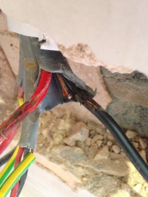

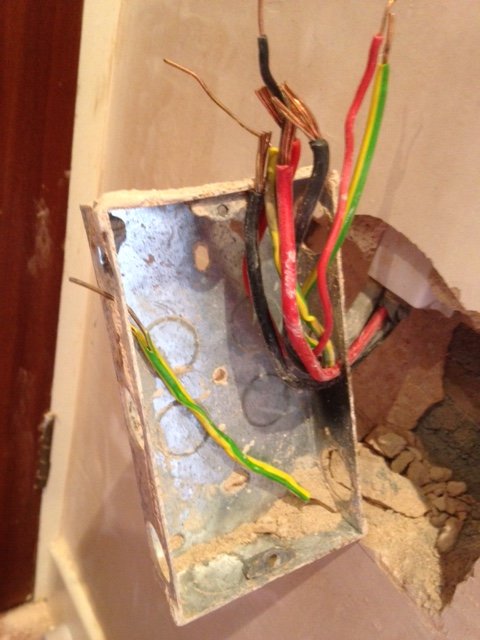

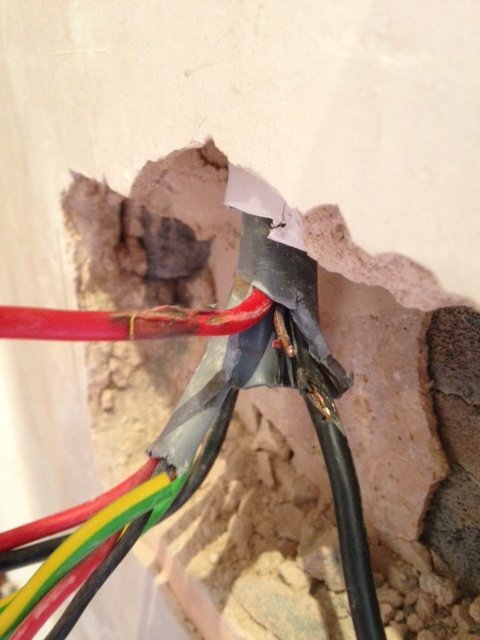

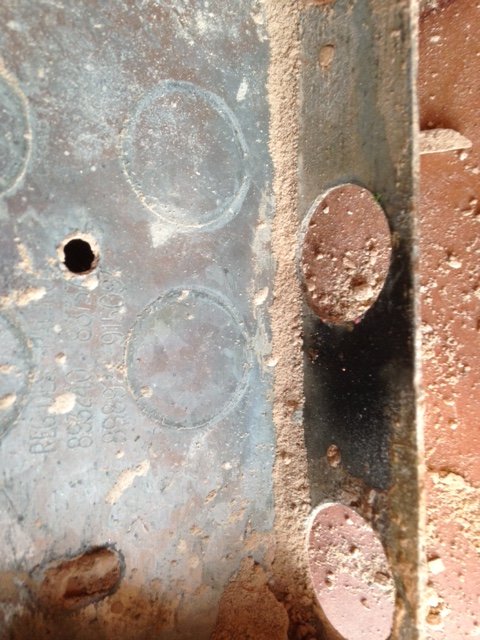

Maybe it should be about 'no grommets'. Came across this today. The earth sleeving had melted and was solid on the wire...which just dropped off. Shows just how important they are.
Look carefully and you can see some red pvc near the end of the earth wire.
View attachment 28485View attachment 28486View attachment 28487View attachment 28488
One bleedin' good reason to totally dismiss the comments in #7
And there was me thinking that the cable sheath should pass through the knockout with or without a grommet being present into the back box. I'd say that the damage to these conductors is a direct a result of bad stripping/termination and arrangement of the cables within the back box, Especially with all 3 cables passing through a single 20mm knockout... Obviously a grommet would have helped, ...well maybe!! lol!!
Reactions: 1 person
Aye, maybe:smile5: and every top and bottom knockout removed. It wasn't a dead short....nothing blown, hence the heat effect....and with all the blackening, it's obviously been getting pretty warm. The only reason for removing the socket was to find the supply to an outside lighting controller...so two 4mm's for the ring and a 1.0mm for the lights, straight to the control. Lucky they let me look for it... would have been paying for an unknown internal wall heater.....'till it blew :icon12: ...among other problems.
