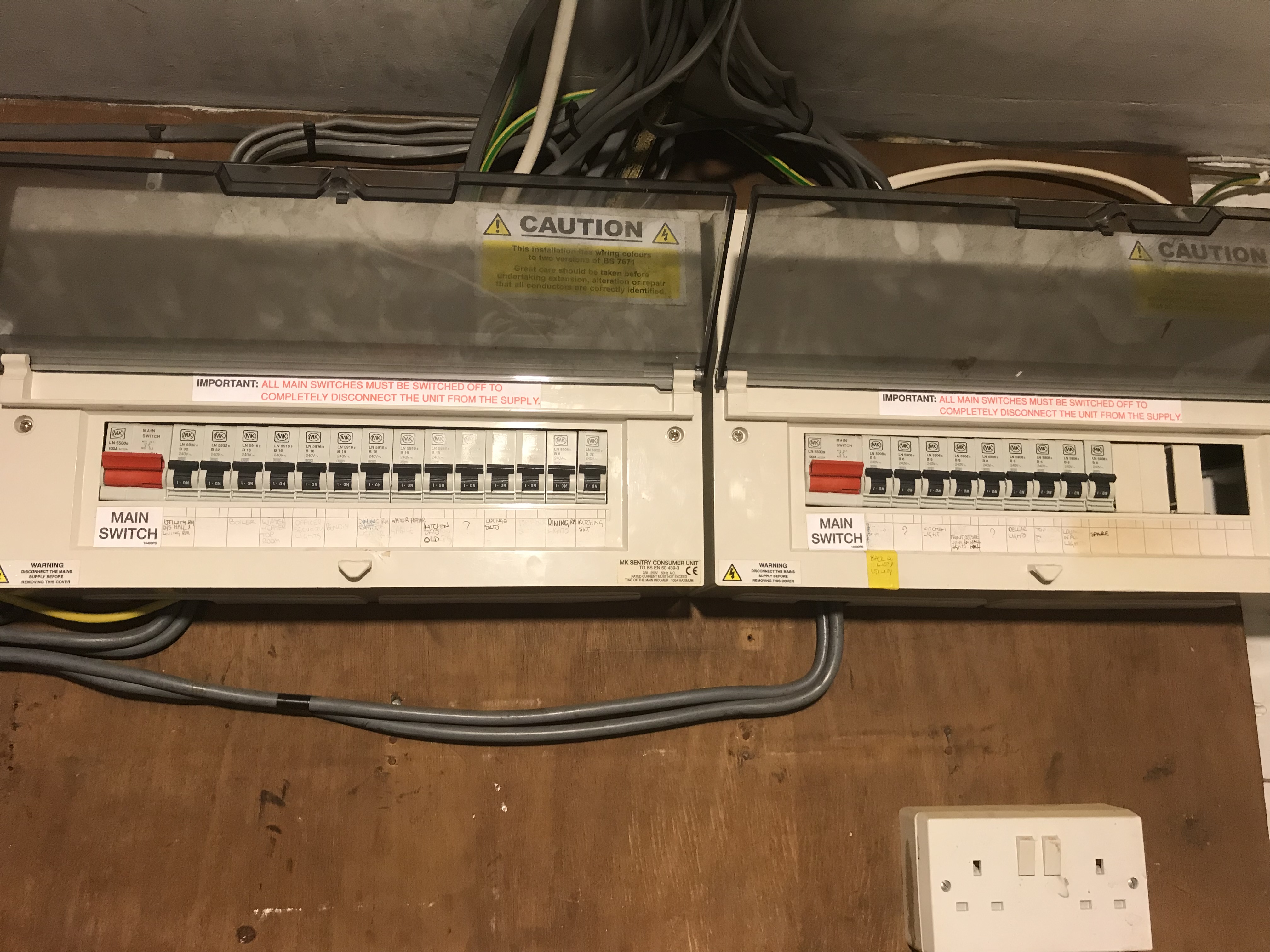

Hi all
I am looking to add 2 additional 2G sockets to an existing 16amp radial circuit that has 2 1G sockets on it.
It’s a 3 story house and the consumer unit is in the Cellar. There are two rooms on the top floor and two radial circuits are feed from the one 16amp MCB with no RCB fitted.
I want to add 2 more 2G sockets in both rooms on each circuit. The cable is 2.5mm twin and earth.
My question is can I add the additional sockets to the existing raidial circuit with the 16amp MCB or should i / could i up rate the MCB to 20amp?
Thanks

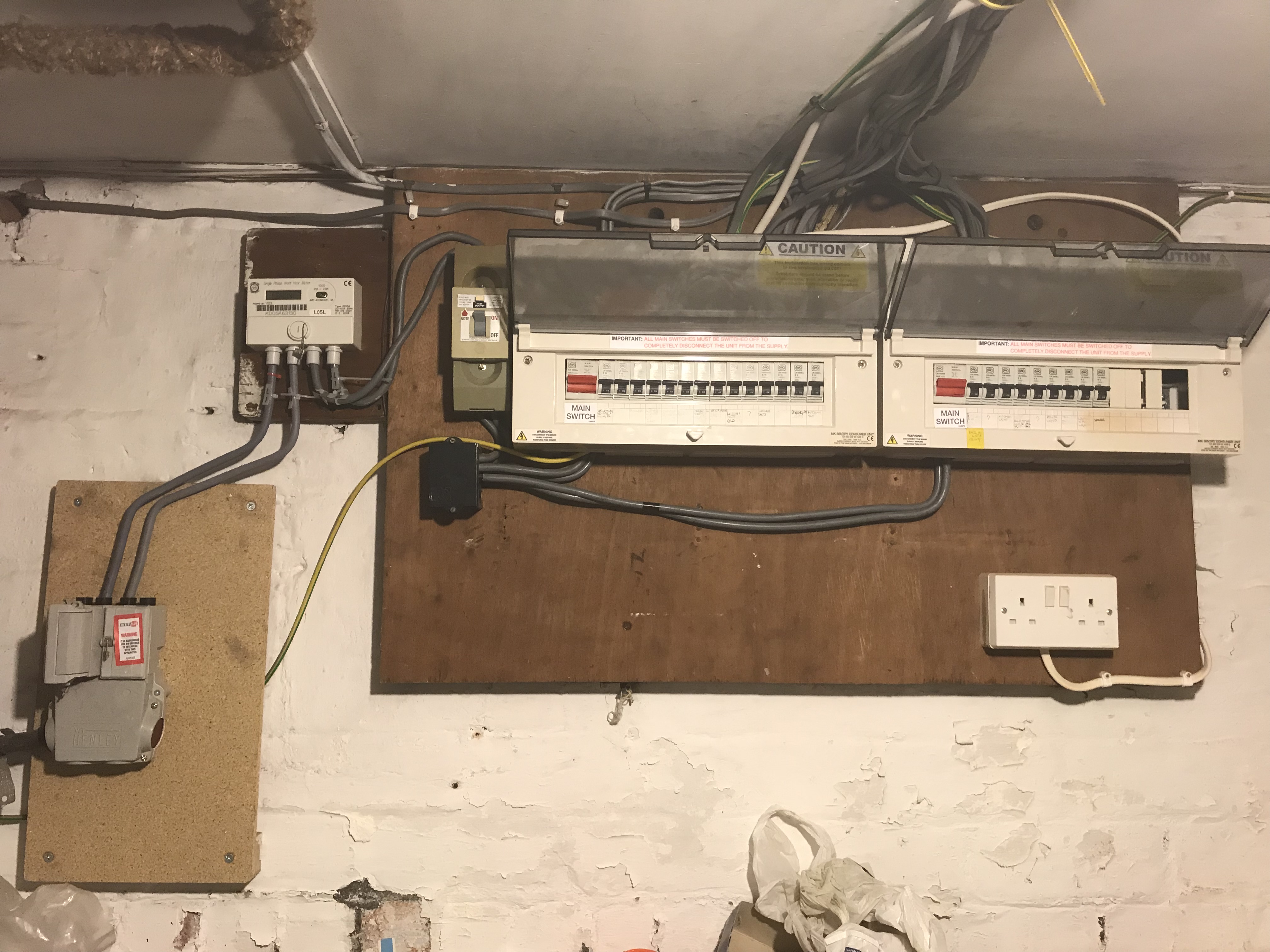

That’s the current consumer unit set up E5BB9E2E-D7E0-4110-9C76-AF14410A9366.jpeg5DF0F404-D293-487C-867C-ADD3587F218F.jpeg
Looks like you have an old voelcb up front and potential shock hazards from the open holes in the front of the right hand board, however the current boards may be suitable for adaption for this job. I'd get an electrician in to handle this small job for you.

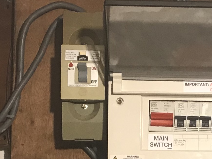

Looks like the upfront unit is an RCD as I cannot see an earth connection to it, though I may be incorrect.

You have a lot of circuits but from the pictures appears to all be on the one meter and not eco7 etc.. looks like space for a rcbo?
Consumer units dont in themselves need changing, they can be tweaked and additional rcds/rcbos etc incorporated into them, this way you keep the existing enclosures and mcbs. it will keep the cost down quite a bit. best advice is call some local electricians around and get some quotes.

You say there is one 16A Mcb controlling two radials, each circuit should have its own mcb.
Yes I have two cables in the MCB and I have had the floor Boards up in the room as I was going to add the sockets myself, it’s definitely two radials.
These either need to be split into their own mcbs or if possible be made into a ring and put on a 32A mcb,
IMO get an electrician to check the installation for you they have the right equipment to ensure yours and your families safety.
not necessarily. 2 radial branches from a single MCB become 1 circuit, although separate MCBs would be an improvement due to separation of circuits reducing inconvenience if the was a fault on 1.
Thanks tel,
I’ve always thought that if you have 2 branches from on mcb being a radial the additional branch may only serve on point as per the “spur off a spur”? As these radials will have more points that is why I suggested the the two mcbs.
no. a spur is only relevant to a ring final. that's because it's a single 2.5mm cable fed from a RFC and protected by a 32a MCB, when that single cable is only rated at 27A max. you can have several radials off a 16A or 20A MCB as that MCB has a In < the Iz of the cable/s.
Definitely an rcd but cannot see its rating. Pretty sure Wylex did not produce voelcbs.

And who would take a chance pressing that ‘test button’ probably not reset - like the old VOELBs
Highly reliable those old Wylex rcds.
  • Agree
Reactions: Richard Burns
And that’s why they don’t make them anymore!
More due to their size, technology moves on to allow a smaller package. Not necessarily for the better.

There is already an up front RCD protecting the left hand consumer unit. The photo's aren't clear enough to show its rating however.
Effectively there is RCD protection to the consumer units and if it is 30mA then adding the additional sockets would not be a problem, 100mA would not be acceptable for a circuit modification.
However the single RCD is not a good arrangement as it does not allow circuit level separation on earth faults.
