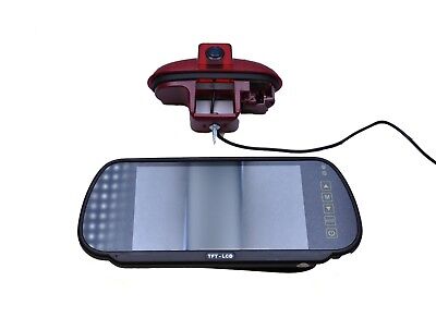

I have this screen. Very good for the money. Can’t comment on the camera - I have a proace. My first camera packed up after it let water in after 6 months or so. I replaced with a different slightly more expensive brake light camera and it’s been good for a year or more.
Total cost including both cameras was about £175 plus a few hours of my labour. All of it is powered from the 12v socket in load area. The screen automatically switches on when it receives a 12v trigger from the reverse light.
