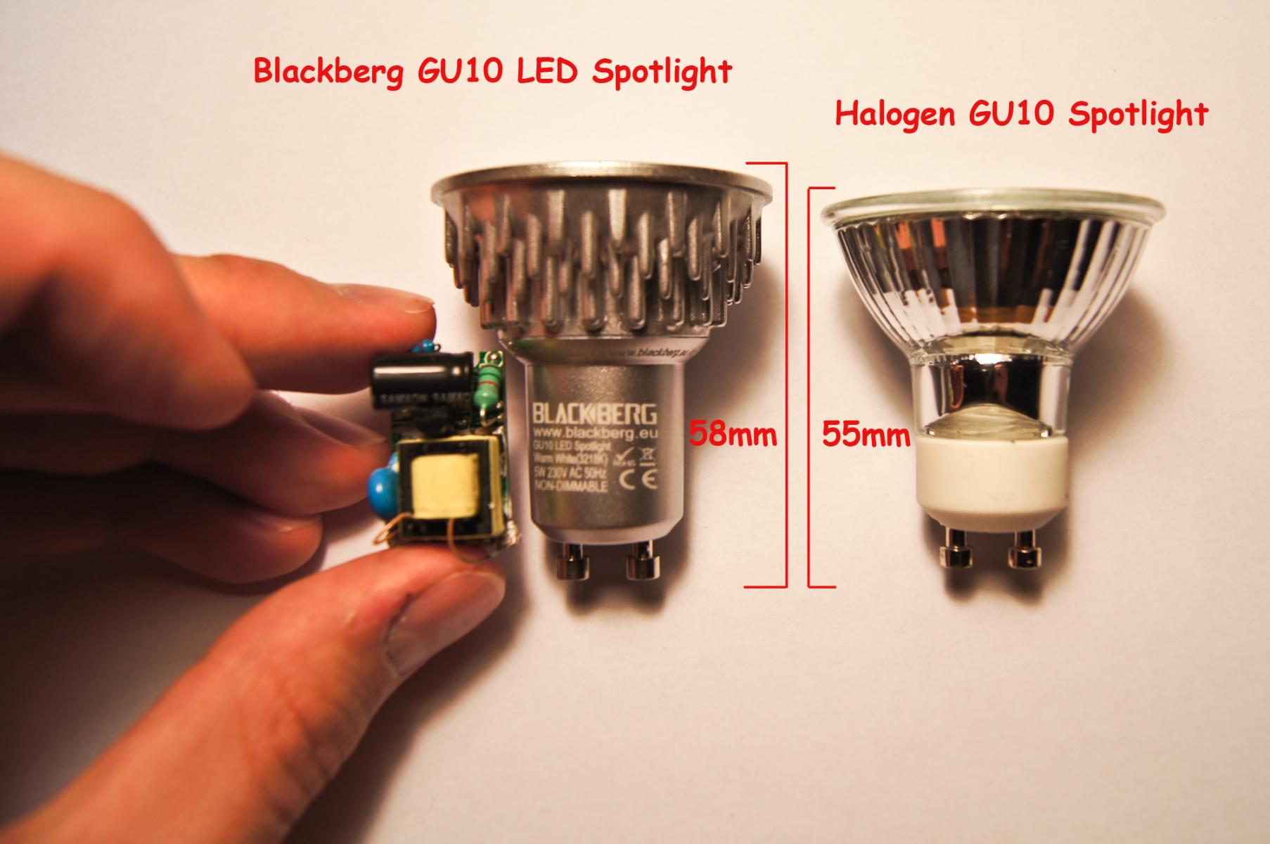

Evening fellas,
I have returned with a product review I spent 3 nights doing!
As Richard suggested above, I needed to take a closer look at the LED light bulb and its circuitry:
  1. I started by unscrewing the "sealing ring" from the top of the bulb. It had been sealed very tightly and I am sure I ended my warranty period when I forced the seal open with a screwdriver and a hammer :hammer:
  2. I removed the lense holder and the lense, and finally saw the LED light source, which looked good!
  3. I wanted to see behind the light source access rest of the electrical components, so I forced my tools under the circuit bord holding the LED's. (At this point I realised I needed to sacrifice this LED bulb for a greater good, because it was not going to stay in usable condition after my treatment) I forced my tools under and brutally lifted the circuit board and destroyed the cables connected to the LED's and ruined the thermal paste and the hot glue
  4. I detached rest of the electrical components, that were found inside bulb. It took a long time to remove protective tapes and pastes from the components, but finally I got everything cleaned up so one could see the components. I was fairly pleased in what I saw. Everything looked good!
Here is the result of breaking the bulb in pieces:
Comparing The LED bulb with Halogen bulb. 3mm difference in height, as Resu mentioned above. After opening the bulb I understand why there is a 3mm difference; the components require the extra space.
I decided to make a video review about the product. I am dedicating it to this forum and its great users. Thank you for giving me so much during these years, I hope you will find this useful.
Remember to click the "gear icon" at the bottom right of the video to change the video quality into HD (1080p) !
[video=youtube;9Hfks8Vks7A]http://www.youtube.com/watch?v=9Hfks8Vks7A&hd=1[/video]
Thank you for the comprehensive feed back on these lamps, it is just the sort of thing you need to be able to make a reasonable assesment of any lamp.
It certainly makes it much less fraught for any one else purchasing the lamps. Thank you being an "early adopter".
