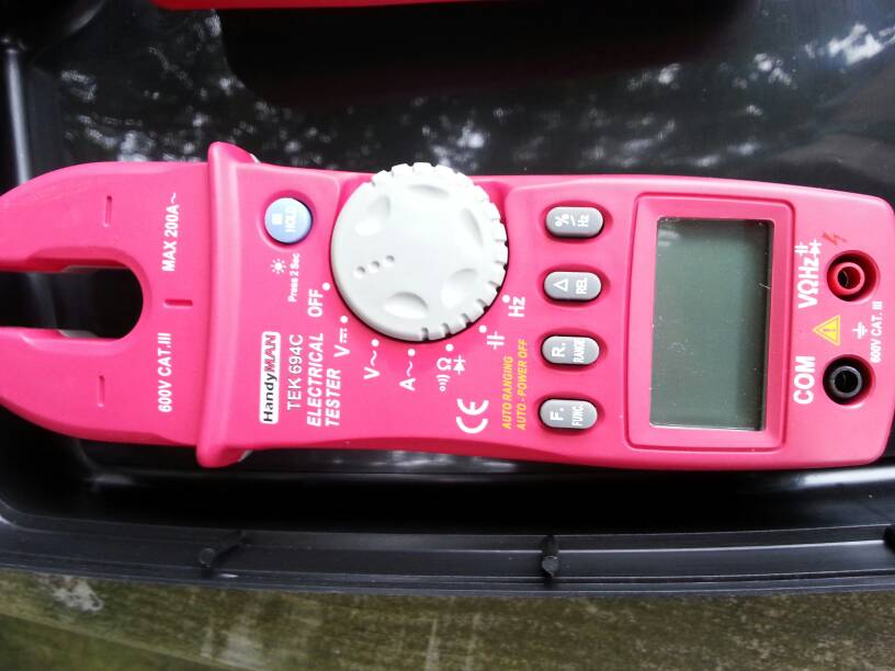

Hello everyone!
I needed a clamp meter on a job last week. It was the first time ive needed one so as i was picking up some gear i picked up one of those Handyman test kits.
I assumed they would be half decent as Handyman is made by Metrel (any opinions on that are very welcome!).
Anyway, used the clamp meter and it seemed alright, if a little sluggish. However trailing the forums this week i have seen multiple mentions of meters such as:
standard clamp meter
r.m.s clamp meter
earth leakage clamp meter
I originally bought mine to see how much current was being pulled as an rcbo kept tripping. However now im thinking i should of got an earth leakage lamp meter.......although whats the difference between that and using a standard clamp meter on the earth?
I usually test earth leakage with the ramp testing method, but is a leakage tester quicker or more accurate?
As always any advice is much appreciate, i can upload pics of the meter or the hanyman kit too.

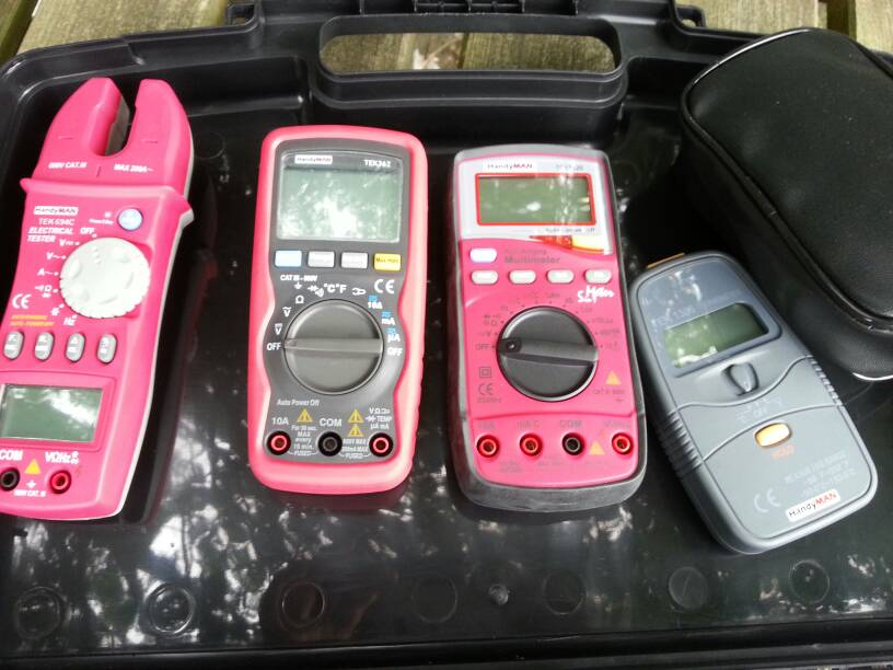

Thats the kit and then the clamp meter up close.
Also, any idea what the difference between the multimeters is? Why supply two?

the main difference is the resolution. a normal clamp meter will not resolve down to mA. for earth leakage measuring, you need a resolution of at least 1mA, some go down to 0.1mA. if you camp an earth conductor, it measures leakage. alternatively, clamp both the tails. the reading (mA) difference in current between the L and N is the leakage,

Yes an RMS clamp meter will give more accurate readings because it isn't adversely effected by distorted waveforms cause by noise or harmonics etc.
Indeed!
Any instrument you get, make sure it's a TRUE RMS job. They calculate the true value as opposed to displaying a theoretical value.
