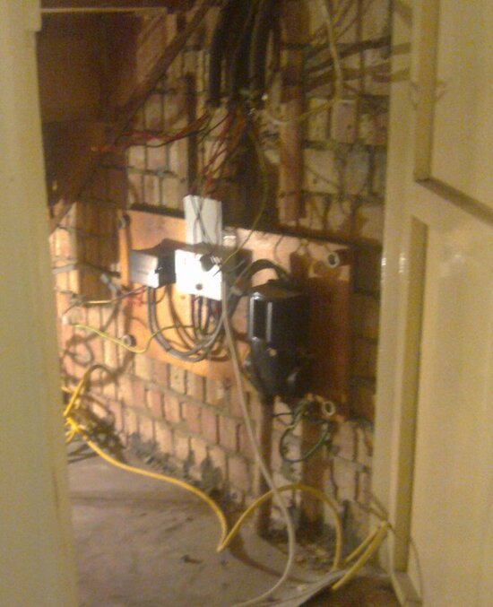

Im finishing rewiring at the moment, place has concrete ground floor, all cables going under the floorboards on first floor or in the loft. There is couple of steel conduits embedded in the building from where consumer unit goes to floor void above. They end up nicely in a metal box where connections can be made (singles in the conduit to twin and earth) Added couple of new circuits and not sure if all will fit in the conduits.
Got 3x 4mm radial, 1x 2.5mm radial and 10mm bonding for water service to squeeze in, to save on space can I run one earth and split it into separate circuits, wonder if thats any good ?
Conduits may be usable for earth but they are old and rusty, metal enclosure on the other end does not have any terminals, its just a box, plan is to drop another run of 10mm earth single and terminate it with an earth block...
