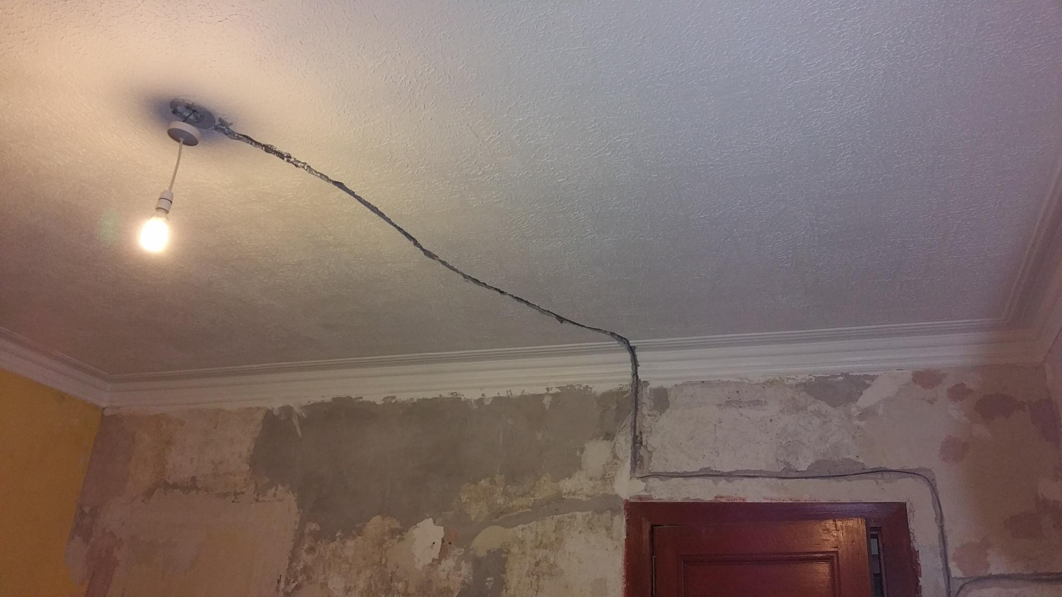

joke.jpg This is the calibre of them cheap re-wires haha
