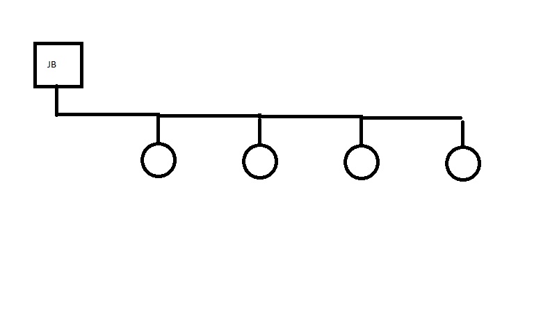

Hi all,
I have been asked to swap an exterior tube lighting thing to 4 wall lights over a shop front for a friend. My question is what would you guys use for the neatest and tidiest way of splitting the cables e.g. From light 1 to light 2 etc etc? I cant do inside the light fitting as they just have a rubber gromit that would only maintain a seal around 1 individual round cable? I am reluctant to use adaptable boxes as they are so big and ugly.
Any advise or ideas would be great???

Hi Hightower,
I was hoping for something a bit smaller than that, something that could be used almost inline. The lights are going in a line over a length of wall so using that would mean having to run 4 wires from the box for the entire length.

No problem, I could but no need really. I could get away with having one junction box at the beginning of the 4 lights but what I want to do is run them 1 after the other. I have tried to show what I mean in the attached pic
Don't bother using the grommit, just seal the entry after both cables have been entered using a bit silicone. I've actually installed lights (can't remember make but decent quality) that don't even provide a grommit and the MI say to use silicone sealant.
I would personally avoid the external junction box. Put it inside and run four cables to each light or if possible run pvc conduit internally and connect at through boxes using Wagos.

Well I often tell customers that I need to see the lights beforehand, and that if they don't support loop-in (or at least 2 cables), it's going to cost them extra and/or they'll be having another box on the wall!
Too many lighting manufacturers don't support the prospective installers. I recently grumbled to "DAR" lighting about a 25mm long "junction box" scarcely adequate for a single and very carefully trimmed 1mm cable, and got the unconcerned reply "DAR lighting don't recommend loop-in".
Try and find lights that have sufficient space inside them for two cables....easier said than done though. And preferably ones you could put a gland on. Keep the cable size down to as minimum as possible. Could use a 20mm conduit round terminal box as they are pretty unobtrusive, with a bush and gland on each exit.
