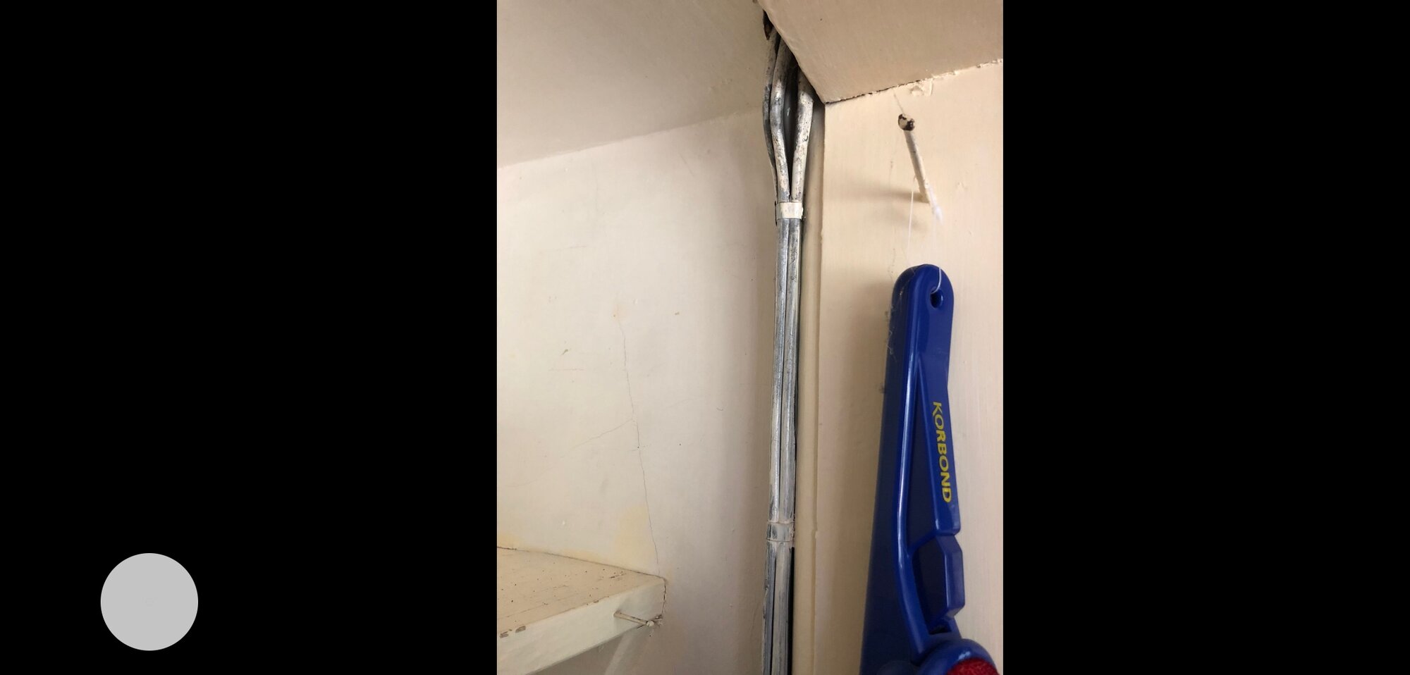

Hi, we are looking at a house but it needs a significant amount of work. The house was built in 1961 and whilst it's been very well cared for it is also very original. We think that it will need to he rewired, given it had double glazing and central heating we didn't give the electrics a thought.
Can you give me a rough idea of cost? This is probably going to be make or break for us. Its a 4 bed property in Kidderminster Worcestershire if that makes any difference.
They have sent me these photos.
Really appreciate any help and advice.

Looking at the pictures that don't fully reperesent the condition of the electrics it is difficult to give an opinion on the current state from afar and an EICR would be the only way to achieve that although it probably would be better to save the money and put it towards the inevitable rewire.
Given the age of the installation a rewire would be the way to go as I doubt that there will be anywhere near the amount of sockets that you need without having leads trailing everywhere which poses additional risk with no RCD's and rewireable fuses
The cost of a rewire depends on what you want / need but a rough budget could be anywhere from £4.5k to £6k - £7K or possibly more if you start looking at fancy accessories and numerous downlights. Also if the house is being lived in that will bump the price up
As above, the only way to find out is an EICR. The cables might be in good condition, however the consumer unit lacks modern safety features and at 60 years of age, many of the accessories (sockets, switches) are likely to be worn out and as @UNG says, probably not plentiful enough for modern requirements. There might also be no earthing in the lighting circuit, which would make it difficult to upgrade without replacing the cable. So whilst there might be an argument for retaining certain cable runs that are difficult to replace without destroying decor, in practice to avoid false economies the most sensible route is likely to be a rewire.
But it should be clear that the reason for a rewire is to replace damaged, worn and obsolete material, and to maintain the value of the house by equipping it for modern living with dozens of gadgets, and to maximise safety and convenience. There is no argument per se that a house wired in 1961 must be rewired.

The actual wiring is a gamble, it might be PVC and in perfectly serviceable condition in which case you could have a new CU (consumer unit = fuse box) for £500-1k, or it might be something very much more dangerous in places and really need the wire replaced. However, it is very much a certainty that all rooms will have too few sockets and if you want anything else done then get it all done at the very start when you are looking at decorating, etc, anyway.
