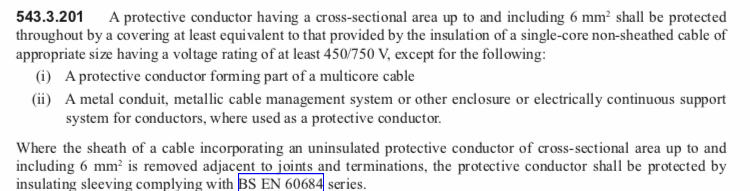

Unless I am misreading it Regulation 543.3.201 would deem those cpcs as no longer adequate so I would not be considering a board replacement unless they were rewired.

I've been on this job to do an inspection before fitting a new RCD OR RCBO board. In most of my career until now the CPC is inside the T+E cable. This property has a separate CPC all through out the building. Only where there has been modifications, modern wiring has been used. If I can prove the ZS is good, is it ok to connect to this system. It's seems to be mainly the lighting that is wired in single sheathed cable which has been ran in conduit. I am hoping if anyone has any information regarding the regs about separate bare earth running through the property. There is a risk of borrowed neutrals if changing to an rcd or rcbo board. The customer does not want a Rewire but wants spots fitted and sockets moving. I have convinced him to change the board, now I am worried about nuisance tripping. However if you could advice about the earth mainly would be a great help. Personally I feel the wiring was good for it's day.

Have suggested it, he has plastered and decorated it. His even fitted a bar. I feel that in these circumstances that an rcd board would be a good idea. As long as I have a good reason . I can even write it down on the cert. What do you think.
When someone opens the board, It has 5 neutrals and 5 live cables and only one earth going out, this can be confusing. It will look look like none of the lighting is earthed.
