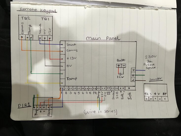

For a basic system with 1 outside sounder, panel, remote keypad, and 3 pir's

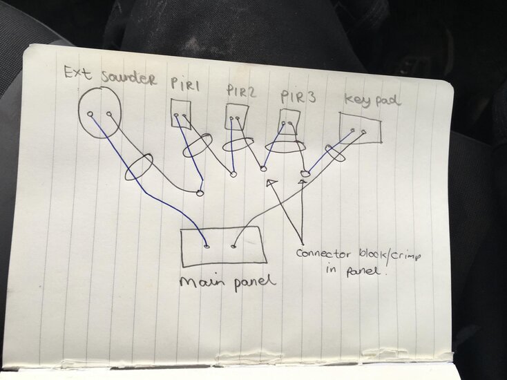

is this very quick circuit correct for the tamper circuit?
will use the green and yellow of the 6core (instead of blue/black lol)
nope. the zone tampers are connected as per your pic. the ext. sounder is separate, as is the keypad. their tampers have their own dedicated terminals in the panel. and also, add the door contact tampers into your series loop. it's all in the install manual. download one and have a look.

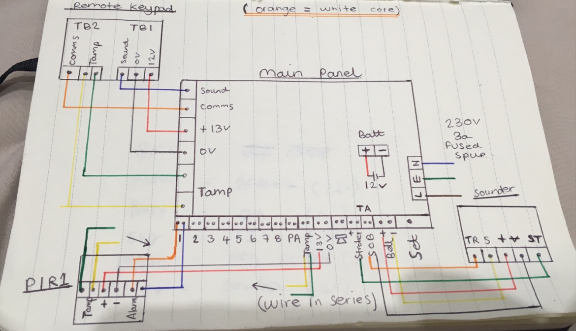

Just need help on the 6 core connections between a honeywell ag6 ext sounder and strobe
and the gen4 main panel- confussing me a lil!
EDIT:
Is it:
SOUNDER>PANEL:
TR- > SCB
S- > BELL-
V+ > BELL+
V- > SCB
ST- > STROBE-
(but thats only 5cores needed? what about the 6core??)
For the bell box only 5 cores are needed. Keep one spare if any damage is done whilst installing :wink:
You've got it, nothing wrong with that mate. Get it installed but please look at preset factory zones and what you need from the panel? I've never made that mistake before,,, honest!!!
