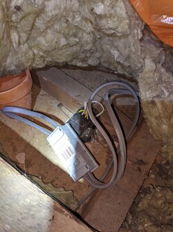

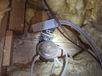

Hello, I replaced some halogen down lights that had been fitted for about 15 years with some GU10s with LED Lamps in them I notices that three of them where cut into the joists a tad and had pipes hard up against them, do you think this is reason to move them or just leave as be, the old halogens had been in for years with no problems?
Thanks Lewis

edit. I misread, I'd be looking at manufacturers instructions if you have replaced the original fittings as well as lamps.
original post deleted,
Doesn't actually state distances just away from insulation and joists which it is not, the ceiling has been over boarded I can't understand why they didn't fit them properly originally.
Kinda agree with Radiohead...much less heat now than before. I presume Bill and Ben fitted the originals?
Yes old lights were halogens with plant pots over them.

Imo if you are just swapping the lights I would leave where they are

I personally wouldn't have put replacement downlights in that have removeable lamps. I know you have put in LED's so the amount of heat next to the joist will be negligible, but at some point someone will put a 50w halogen in. I don't usually fit integrated LED downlights, but in this case I would have.
Also, this is assuming that the existing downlights are just right up against the joist and not actually cut into it (its difficult to tell from your pictures). I wouldn't replace them if they had been cut into the joists as I feel I would be taking some responsibility. I would have told the client to get someone in to check it was safe.
Yeah in places they are cut into the joists, I understand where you are coming from as the one I removed to check hole size originally was done properly, and got the lights and lamps etc and just went ahead with it and now as you say I feel responsibility for the job. I told the guy to only use 5W LED lamps but as you say one day you never know....

You got the right lamps, you gave the right advice...what more can you do?
An email to the client, confirming what you did, why, and what not to do in the future...that's all you can do. keep a record of it...in 20 years time some idiot will fit 50W halogens he bought cheap...not your problem, he will have changed the characteristics of the circuit, not you.
