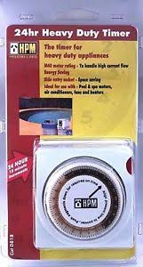

Many of the cheaper ones are flimsy and will not last very long on larger loads.
How ever you can get plug in heavy duty timers, they seem to last much longer
