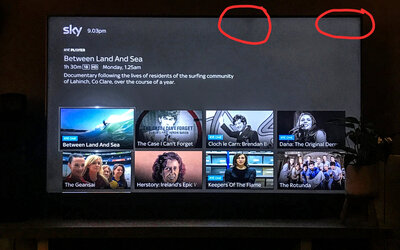

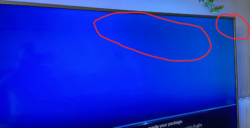

I have attached pictures of the 4 devices that suffered from the issue.
In this order the different devices have developed the dark stains and put in brackets when after the initial purchase date the problem occurred.
1) Hitachi 43HK25T74U J (10 months)
2) Samsung UE55TU710 OKXXU (12 days)
3) Philips 65PUS7855/12 (5 days)
4) Apple iMac Retina 5K, 27-inch, 2019 (10 months)
I did not have these issues in the two previous apartments in which I lived in the past 1.5 years.
I'm aware of the burn in some TVs suffer, but since this has appeared after just 5-12 days with two brand new devices I can safely exclude this option as I do not use the TV more than 3 hours a day.

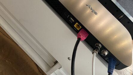

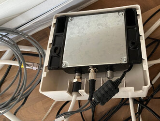

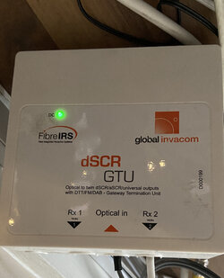

@darkwood: this is indeed an interesting thought as I had a technician here that has installed Sky around the time the shadows started appearing. He had installed a satellite box with an additional power plug of which I have taken a photo too. It is connected to the communal satellite dish on the roof. Moreover, the Sky Q device is connected via HDMI to the TVs.

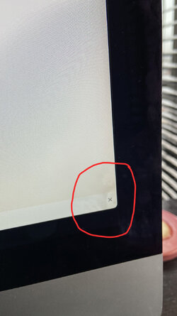

What does confuse me is that the 13 month-old iMac has also developed similar stains without being connected to any of the same devices or plugs, in a different corner of the living room.
Could the Sky Q box and/or the satellite box be a potential source of this error?

Do you have kids (and possibly pets) knocking against the screen? I have seen that mess up panels with soft plastic fronts. Doubt it would explain the Apple as I think they are glass fronted.
However, it is more likely to be just poor manufacturing as many folk would not notice (or react to) that sort of change.
Those look like mechanical damage to the panels. There is nothing electrical or electronic that can realistically cause such random patches. Electronics faults usually manifest as sharp, square-edged blocks or lines that are completely dead or the wrong colour, backlight faults usually as darker zones of otherwise OK picture but again in a defined area that corresponds to the backlight failure. Mechanical stress on the panel or backlight diffuser films often manifests as dark or light patches around the eges or corners because that is where the panel is most tightly clamped into the casing.
So whilst there might be a common factor, I don't think it's anything electrical.
You could skip over to this forum, where you might find owners threads on some of your newer devices. Difficult to tell from your pics, but as said it might just you've been unlucky;
But as I said before, it might be you are just a bit more critical, say more than me; do you notice anything when watching a full displayed picture, or just when faced with a blank screen?
Agree with all the above - that's almost certainly not an electrical issue. I would say that's either pressure applied to the screens, or possibly moisture?
I would say moisture. I get similar marks on my laptop when I've been using it in the rain. It (usually) dries out after a few hours on a hotel radiator.
Looking at the white screen one, that looks like screen uniformity not been good, given these are budget models for that size screen it is to be expected the quality of screen build will be lesser than a top end one, I have a flagship model and still have a little screen uniformity issue with that.
