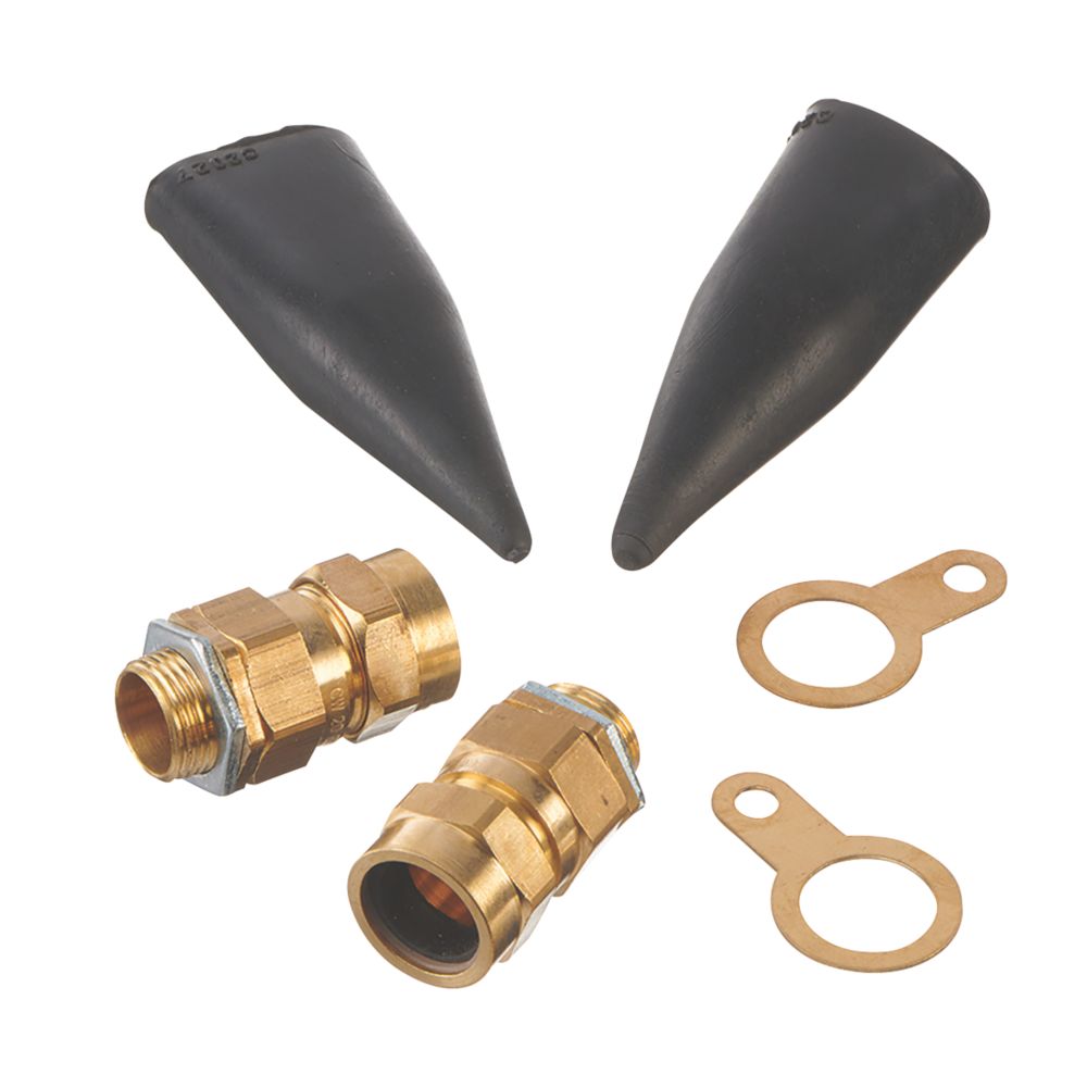

The issue for me would be selecting the right hardware to correctly terminate the swa cable and safely connect it into the existing outdoor socket, given this is all outdoors.

Use outdoor cable glands and ensure the armour of the cable is earthed.

There are “weatherproof” SWA glands available… ie 20CW…. The 20BW are not weatherproof…. Or you can get the “Storm” glands which are also IP rated.

The glands I have purchased are ip66 rated as is the outdoor socket that I will be using.
The codes you are quoting are unknown to me. Should I also be looking for 20CW?
Any ip66 gland is fine. 20CW is just the manufacturers code for it.
Actually, make sure your glands are for SWA, not just a compression gland with a rubber ring that closes up when tightened

This is the kit I purchased (from Screwfix - see link below.) I have assumed that this will provide the appropriate fixing. Am I correct?
https://www.NoLinkingToThis/p/deta-brass-exterior-gland-kit-20mm-2-pack/637vt?ref=SFAppShare
Yeah, that’s exactly the same as a 20CW.
The armour is gripped between the two brass parts for earthing purposes, then the compression part is tightened around the outer sheath of the cable to create a waterproof seal.
Then the shroud is slipped over the top of all of it.
