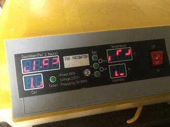

Heya I have a pct heating element for an egg incubator it’s 220v 80 w
atm it’s wired to the old circuit but mid incubation all the digi display started flickering and now I can’t read the numbers

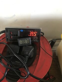

I baught an external plug in thermostatic controller for lizards you plug a uk plug into and it controlls the heating
however I just want to make sure I am safe to wire this directly to a plug with a 3a fuse
or if I need some kind of protection regulator Between the element and plug ?

I did say I have a thermostatic temp controller for blizzard tanks and incubator
But it requires I plug in a heating element that is uk plugged
So it is controlled it’s set to 37 but unless I put the pct heating element on a plug I can’t plug it into my thermostat

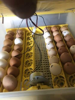

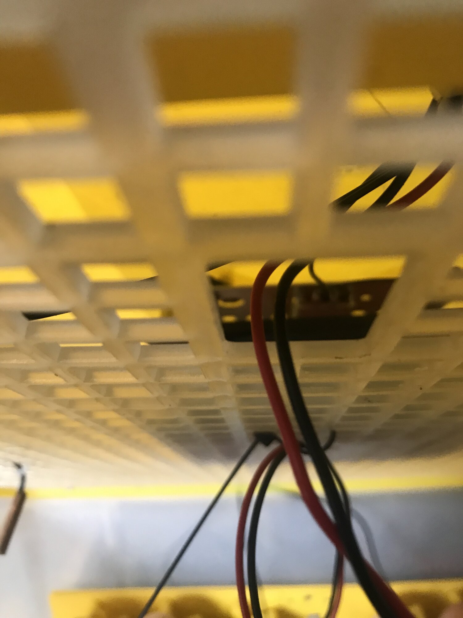

as you can see the numbers are strewed flickering so I want to remove the working element and make it able to plug into my external controller seen on the bench with a plug socket on it
the temp is 39 and needs to be 37 but as I have eggs in I can’t turn off the current incubator flickering controller and I can’t alter the pre settings to reduce temp someone pressed reset and it sets to 38 I had to dial it down to 37 but since flickering started and someone pressed reset I no longer can edit the settings as I’ve no clue what they are
this external controller is the real deal but it needs the element to be on a plug instead of directly into the broken controller board which costs a fortune to replace when this controller does the same thing and I have it already

So your thermostat has a 13 A UK socket where you want to plug in your element? How do you earth the element then as it only has 2 wires ? Which I do not think is double insulated, Are there any labels with a square within a square symbol? Is the incubator casing metal at all?

The 230V element is a component, not a complete retail electrical product. I can imagine people use just the bare element but this is not the intention.
It is supposed to be built into an appliance or housing where the manufacturer makes sure it is earthed, that the single-insulated leads can't be touched or pulled out, etc. If you want to build it into the incubator, it's up to you to ensure these safety provisions are met by design. I would expect to see it mounted onto some kind of heatsink or radiator, with its wires and a chassis earth connected to a terminal block. A power cable would be securely attached to the housing and a guard fitted over the element and terminal block.
