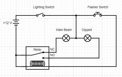

I could clearly hear the relay clicking, but the lights didn't change. This is a simplified diagram of the circuit with only one side shown:

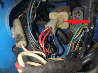

The flasher switch operates the headlamp relay, but it's a little odd in that in the default dipped beam position the relay is powered. Pushing the stalk forwards (or pulling it back to the 'flash' position) will remove power from the relay coil, causing it to change state. All of the switches were working correctly, but the relay output wouldn't change. You can see the headlamp relay arrowed:

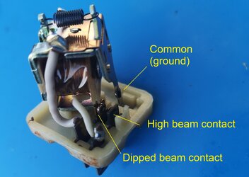

Eventually I pulled the relay and opened it by prising back the dimples in the case, and this is what I found:
It's a little hard to see, but the relay moving contact wasn't touching either of the fixed contacts. The coil was pulling in mechanically, but electrically nothing was happening. If you look back at the first photo, you can see a small Philips screw to the left of the arrow. It seems someone turned this screw.
So why were the lights working at all? The screw had been turned clockwise and this rotated the frame of the relay until it lodged against the dipped beam contact. It was a fluke that the headlights worked at all, it was the accidental short circuit that kept them on.
The main beam contact surface was pretty poor, so I advised the owner to track down a NOS relay.
