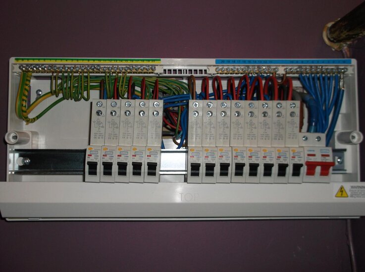

Not a large board - though fairly crowded, but here's a small one of mine towards the end which must have been temporarily energising just one circuit (can't remember now) as there's no bus bar in there yet and a couple of circuits yet to connect. I sometimes use ties used to keep tidy during assembly then remove at the end. Note the replacement ferrules on the earth leads, all cut to a more sensible length as also the neutrals, though I don't tend to worry too much about ferrules on the end of those as they pretty much fill the terminal anyway and make a sound contact. It also looks like the earth bar wasn't behaving itself that day either!!
Nice job
I ferrule everything now days

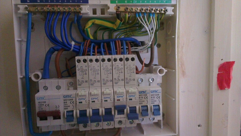

The RCBO'S are wonky :jester:

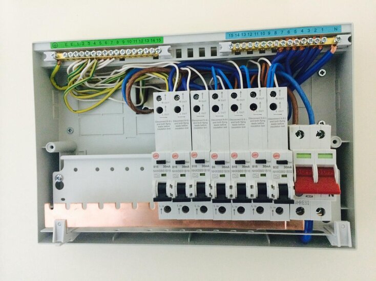

Good work !!!!
Have you tried to get a spirit level in them , oh BG do all i need now is for BG to do an RCBO with a spirit level and im sorted ,, Get all my BG boards from screw fix best prices round here non of the local suppliers will supply them aindowsimon
