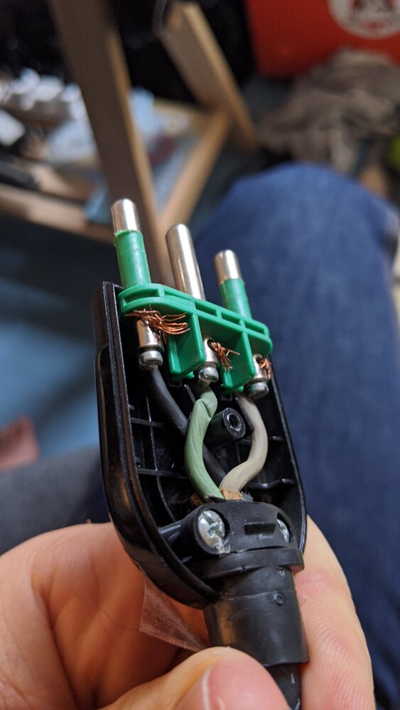

I'm wondering if anyone can help me see if this is possible.
I bought this Mole Richardson 650w Lamp on ebay expecting it to come wired with a UK 16A plug, but it instead it is this odd Italian 16A.
Would I be able to re-wire this to a UK 13A plug? Oddly it appears the ground and neutral wires are green.
Thanks for any help all!
Looks like brown, green and black on the photo.
Is it definitely suited to 230V use? Is there a rating sticker?
Thanks for the response!
That explains it, my colour blindness is to blame. I'll get someone else to do the rewiring.

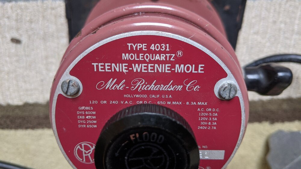

The lamp itself claims '120 or 240v AC' and the print on the cable itself says 600v

Have you got a photo of the lamp?
The 300w bulb/lamp that is in - is that rated for 230V use?
It says 220v on it, so would that blow in that case?
Thanks for the help!
Should be ok, they are usually rated for 220 to 240V.
Ah ok great, so this should rewire to a UK plug with 13A fuse without issue?
Thanks for all the help!
I don't see why not, but to be on the safe side let's see if another member will agree. Just in case I've missed anything.

Haven't seen one of those for ages! Yes, absolutely fine to rewire the plug type - just make sure you get the colours the correct way or you'll end up with a live case!

Yeah she works after rewiring!
Thanks for the help all :)
Great stuff, thanks for letting us know. Did the earth continuity from plug to lamp metalwork get checked?
