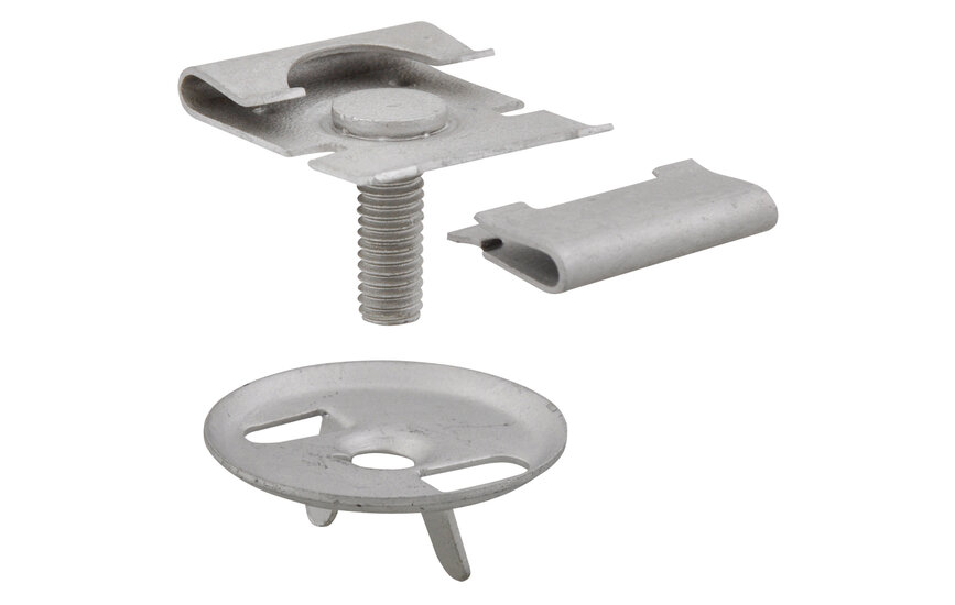

I've been asked to move the existing lighting and put some new lights in a shop, customer has brought the fluorscent lights, I did suggest modulars but looks like they want to do it on the cheap. The existing lights are drilled and screwed to the framework of the suspended ceiling, are there brackets I can use to attach the lights to the framework instead of drilling.

Butterfly clips. They are like and 'x' with a small but of rod i suppose that clamp and then a round threaded disc which obviously tightens up through the fitting

butterfly clips. they twist onto the grid and have a 6mm pin coming down. clip on. fitting up, 2 nuts, job done.

It seems you’re after ‘Tee bar clips’ for suspended ceiling grids. There are a few different designs as shown below;
