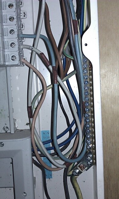

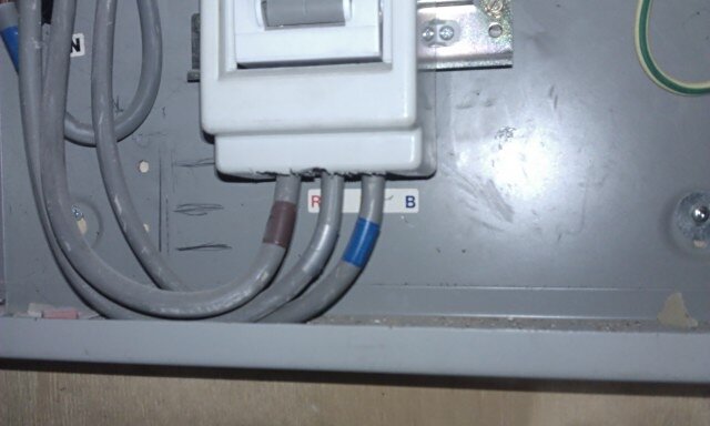

If I can offer you one tip from 25 years experience fault-finding, it's never to take anything for granted. I've been to a site where a pump motor had been running the wrong way for 18 months before anyone noticed. How about a TP+N DB that had the same phase twice (L!, L2, L1) that had been in use for years supplying only single-phase loads. Would you be certain of the phase rotation at these boards?
