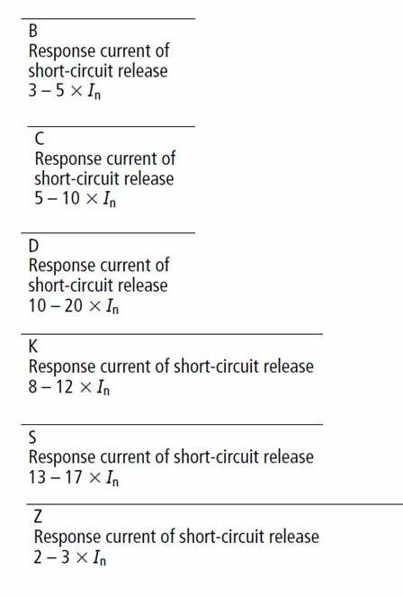

It tells you in the catalogue, they have different factors of In for tripping:
It's a bit like a time delay RCD used for discrimination or something like that according to Moeler who make them
type s breaker
