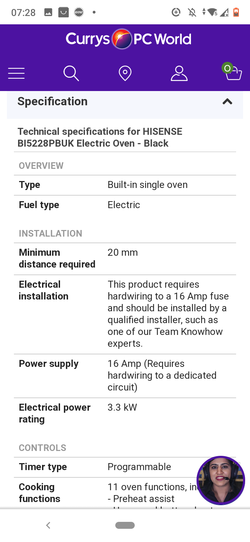

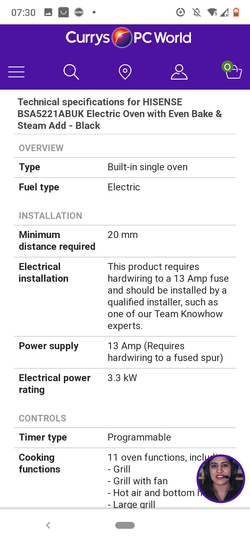

Thanks I got the info of Curry's website I've attached screenshots of it.

Unfortunately websites are very bad at giving the useful information on ovens/hobs etc.
In this case, the manual for the hisense bsa5221abUK doesn't help either -as it says "Instructions for installation and connection are supplied on a separate sheet." which isn't available for download....
The only thing it does seem to mention is that a means for disconnection must be provided.
I personally would not consider it appropriate for a 3300W device (13.75A even at 240V ) to be put on a 13A fused spur, Many fused spurs will simply melt if run at anywhere near their full potential for any length of time. Personally I'd put that on a 20A DP switch usually from a 20A breaker if newly installing, and in this case I'd just re-use the existing wiring and connect straight to the cooker point.
It's also not clear whether either oven comes with a flex, but anything of 2.5mm flex or bigger would be likely to cope with the fault on a 32A MCB in any case.
If an electrician will be doing it anyway they could run the calcs and confirm - or just use 4mm or 6mm flex to the oven if necessary to ensure the cable is protected.
It would be interesting to contact HiSense and ask them why their two ovens, with apparently the same rating in kW, are stated as requiring different installation methods.
I wouldn't be surprised if these are 'converted' instructions from european market models, where 15A single circuits are often the most common it seems...

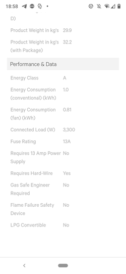

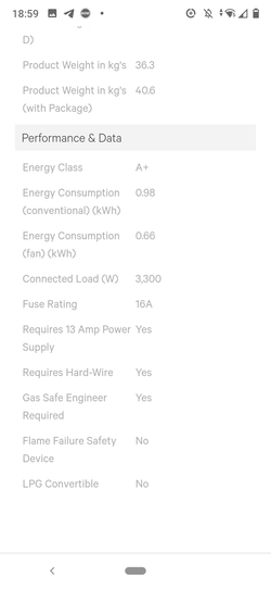

I found these on hisense website what I don't understand it's states the 16amp oven needs 13amp power supply and a gas Safe engineer no idea why as it's not gas and the 13amp one doesn't need 13amp power supply.
Yes, I suspect that's just a plain error - quite common sadly - sometimes even the manual that comes with it doesn't clarify things.
