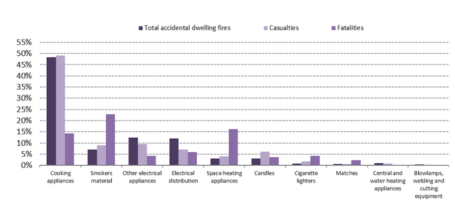

I've had a quick look at some publicly available data:
Percentage of fires, non-fatal casualties and fire-related fatalities in accidental dwelling fires by selected sources of ignition, England; year ending March 2020
So electrical-appliance ignition source caused 13% of fires and accounted for 4% of fatalities.
Electrical distribution ignition sources are in fact killing more people.
(Space-heating source fatalities are really quite scary - people plugging in a fan heater in one room and not running the CH is going to be a real issue)

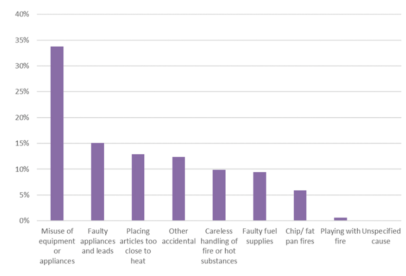

But maybe more relevant is this graph (same year)
Percentage of fires in accidental dwelling, fires by cause of fire, England; year ending March 2020
My conclusion for now - If 15% of fires are being caused by faulty appliances then maybe our advice should simply be that AFDDs are an attempt to bring down that number. The reality is that we won't know if it works for several years.
