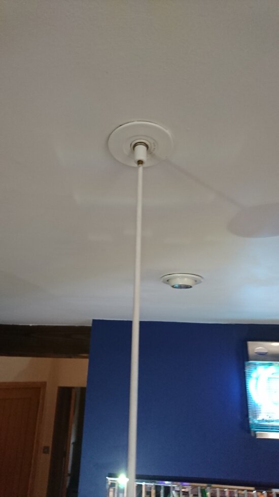

As the title states, has anyone seen where to get one of these from or know what they are called?
Sorry about the people in the picture.
All the wiring must be behind the metal plate on the ceiling. What looks like the cable dropping down to the light is actually a metal rod. The live must go through the centre and the neutral returns on the outer. The metal rod screws into the plate on the ceiling.
Thanks for any help.

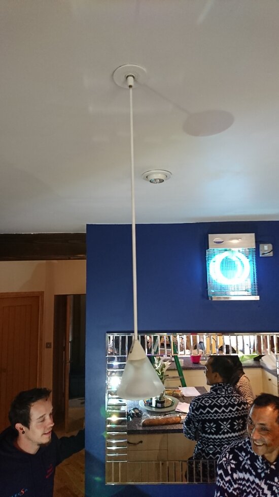

It's some kind of pendant light which incorporates a rod instead of a cable; it's more likely that the rod is hollow and both wires go down the centre of it than the rod forming the return path, which sounds dangerous.
The exact particulars of that light would be specific to the manufacturer - it's not as standard as taking a couple of blurry snaps and asking what you call it, you'd be better off looking for some identifying features on the light itself like a manufacturer or part number.

Unfortunately there are no markings on it or any writing to identify it.
I was hoping someone might have seen one in the past.
Anthony. Yes, this one has stopped working, I can't see any way it could be taken apart to be repaired.

I think the rod part justs clicks in and out and the ceiling part is installed with like downlight wings. If it is E.L.V. there could be a transformer above. The existing other lighting could be a clue of the manufacturer and type of lamps fitted.

Looking at the end of long bar at the top there is an inner part that is insulated from the outer, the outer is threaded so when it's screwed in the centre part connects to the live. I can't even see how to remove the ceiling part.

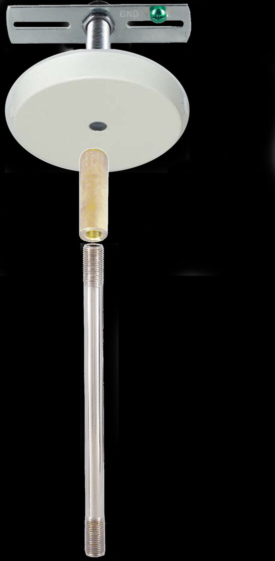

I would have thought it was arranged something like this
A bracket (or conduit box) at the ceiling with a threaded rod, over which the ceiling cover plate is placed and a coupler threaded on top to hold the plate and to allow the pendant rod to be connected to the coupler.
Richard- No it's nothing like that.
