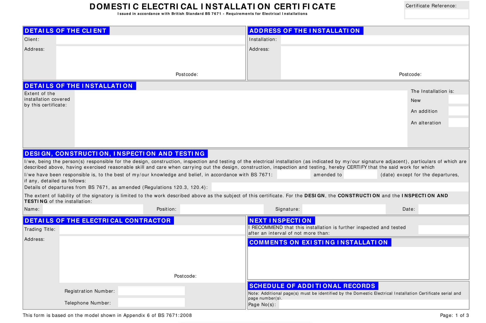

It might help understand why another electrician would not want to complete an EIC for work done by another, even if he trusted him, if you read what the signatory is declaring on the form:
That is why it was suggested, if the Building Inspector would accept an EICR, that would be a more pragmatic way of resolving the issue.
