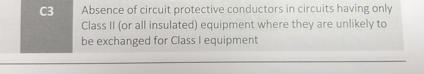

EICR picked up no continuity on cpc on 3 pendants fittings in a grd Floor Flat.
Zs measured @ other pendants & complies.
Different opinions on the coding personally a C2 for me..but others are saying C3 mainly because of the code guidance in code breakers.
I think this statement relates to no cpc in cabling, the circuit above are all Class II fittings mainly pendants & batten holders.
I often come across jobs where the lighting is wired in T&E but the lazy sparks rather than connect the cpc they snip them all out at the switches and fittings.
which is a real fig trying to get just enough on the cpc to attempt to get a joint onto it. sometimes is possible sometimes not possible. Imo snipping all of the cpcs out leave the job in an unsafe state and I would code as C2 as at any given stage the home owner can put up a metal fitting or metal switch
That statement isn't relevant as there are cpcs present, Code 2.
Code 2 as well.
It could easily be changed for a class 1 light fitting by DIY Dave. Plus, the CPC's are not absent, they are there and not working.

Agree try telling Others… I’ve actually coded C2😎
