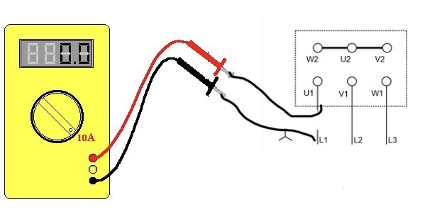

Hello everyone, friends. In cases where I do not have a clamp meter, I want to measure the current drawn by the phases of a 3-phase motor with my multimeter. I left a picture below as an example. I connected my red probe to 10A., my black probe to Com. After turning the multimeter to 10A; For example, where should I connect the red and black probes to measure the current drawn by the L1 phase?
You would have to disconnect the L1 wire from the motor and put the meter in series with the connection to the motor.
You cannot do it by just probing terminals.
That is why a clamp meter is so useful, as you do not have to interfere with the wiring.

I will remove the L1 phase from the motor and connect it to the Black probe, then I will hold the red probe to the U1 input on the motor. Do I understand correctly?
Before doing this you must first determine what the maximum start-up current for the motor should be, and that has to be less than the multimeter is rated for.
You must also be sure the meter is rated to at least CAT-III safety. This means it will have a fast internal fuse for the current range(s) and if the start-up current of the motor exceeds this by any significant amount it will blow the meter's fuse. If that happens then you will need to replace the fuse with another of the correct current and breaking capacity rating.
Making a mistake with an inadequately rated test meter can literally result in it exploding in your face. Not joking here, sadly folks have died that way.
The surge can be dealt with by connecting a single pole switch in the L1 supply, rather than breaking it, with the meter leads connected to each switch terminal.
Start the motor with the switch closed, and then open it.
An alternative method of measuring the run current is to fit a low value resistor in series with each supply. The resistor value and wattage should be chosen, by Ohms and Watts laws, so that there is a couple of volts or so across each resistor at the expected run current.
Measure the resistance of each resistor accurately, and then measure the voltage across each resistor with the motor running. It's then a simple matter to calculate the current in each phase.
Although @brianmoooore 's advice is very good and useful, I have to side with @Avo Mk8 & @James that as soon as you have to do anything fancy to safely use a multimeter, you are better to simply use a clamp ammeter.
Generally if the expected load is above an amp or so (so switch-on surge can take out 10A fuse, for example) and especially if you are trying to interrupt a live circuit or working on anything with high fault currents, then a clamp meter is the way to go.
True, the jaws can be too large for some locations, but a short length of comparable wire to give to a long enough cable to measure is about as safe & simple a change as you can make to facilitate the test.
I wouldn't do this test by just holding the probes onto the terminal and wire, you need to figure out a way to make the probe connections more permanent and less prone to moving around or slipping.
I'd advise against doing the test this way although it's not inherently a 'bad' test there's several ways it could go pear shaped for someone that's not experienced.
Of course a clamp meter is far preferable, but my post was to illustrate that there's more than one way of killing a cat, so to speak.
Both my methods avoid the problem of switching heavy currents with meter probes.
