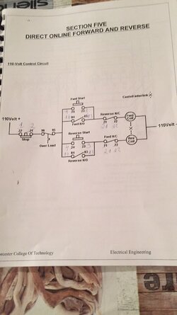

Do you have a question on the Direct OnLine Forward/Reverse schematic?
Do you need it explaining to you?
Also, why not try and get into the Trainee section of the forum.
Ok, I will explain how the circuit above works.
This is just the 'control' section of the motor.
You have 110V going through the Stop button and Overload contact. It stops there as all the other contacts are Open.
If someone was to press the Forward Start button the this would make the circuit going through the Forward Coil and energise that contactor. This would also make the Normally Open Forward contact close, latching (locking closed) the circuit through the Forward Coil, so when the Forward Start button is released the Forward N/O contact (which is now closed) keeps the circuit.
TO open the circuit the Stop button has to be pressed or the Overload contact has to open. (This happens the the motor detects an overload)
If someone now presses the Reverse Start button then the Reverse N/C contact opens the circuit for the Forward section and makes it for the Reverse section of the circuit.

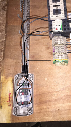

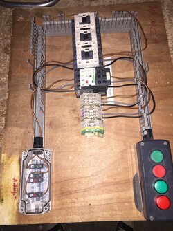

Can You make some drawing please , still confused .After overload 95 back in start button 4 or back in Frw contactor .2F67C90C-6EF7-4E9D-A9BF-29B942F3C849.jpeg
[automerge]1570097205[/automerge]
The wire from the Overload contact (Pin 95) will connect to FWD Start button (4), REV Start button(4), FWD N/O (14) & REV N/O (14)

I don't see any power going into the assembly he has set up but I'm assuming all the parts he has are the correct ones and he has the correct voltage.
No just following drawings, This is not my just example.
[automerge]1570099681[/automerge]
Ok, so just so that I'm clear on this: You are just following the drawing and picture, to see how it works and not actually wiring anything up?

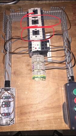

the forward and reverse contactors are both identical.
the difference is the power going to
forward contactor is wired L1 L2 L3 from left to right
reverse contactor is wired L3 L2 L1 from left to right
this gives either a clockwise or anticlockwise phase rotation.
it helps if you mark them as fw and rev before you start connecting anything as this will help you identify what you are wiring to.
This is just example, but how do you know with one contactor is Forward and with Reversing?
The Forward Contactor will be the one with the Forward Start pushbutton wired to the N/O of that contact.
or if nothing is labelled up then:
As the Forward & Reverse circuits are functionally the same then just pick one for Forward and the other for Reverse. The actual Forward & Reverse wiring for the motor is not part of this circuit.

The same thing 3 phase motor used brown,black and grey cable ????
the theory behind it is L1 L2 L3 gives a clockwise phase rotation and it is a repeating pattern,
L1 L2 L3 L1 L2 L3 L1 L2 L3 and so on
so if you pick any 3 that are next to each other it will give clockwise rotation.
i.e L2 L3 L1 is still clockwise and so is L3 L1 L2
convention and simplicity means that we wire 1 2 3 but the other options will work the same.
