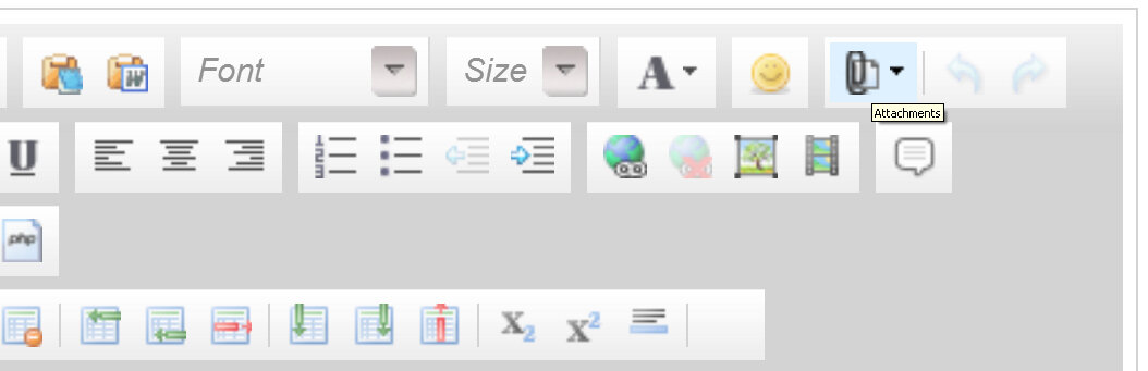

If you cannot add a picture using the insert image button, have you tried using the attachments button in go advanced
and then adding the file to the list (if the computer option is available) upload and insert inline?
This is how I got this picture in.
