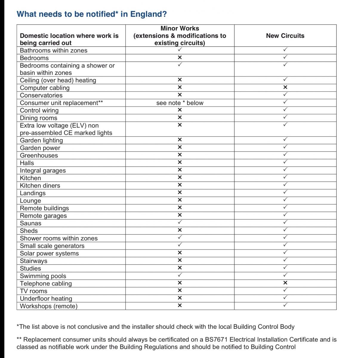

my question is do I have to be registered with a competent person scheme like the niceic or elecsa to issue a minor works certificate after doing minor works in a clients dwelling?
i have completed my part p and 17th edition also testing and inspecting
thanks
if you dont sign up then you need to notify building control before!!! work comences
if you join a self certification scheme e.g. nic, elcsa,napit, stroma etc then you can notify after
usually the yearly fee is cheaper than paying the fee to labc 2/3 times

List of Notifiable work.
Thanks for posting that grid it's a useful reference.
I found this one which basically says the same thing.
Quoting from:
Page 15 - 1.5.2 - IET - Electricians guide to the building regs.
Regulation 12(6A) of the building regulations 2010 describes notifyable work as follows:
A The installation of a new circuit
B The replacement of a consumer unit
C Any addition or alteration to existing circuits in a special location.
You would also need to consider if the 'minor work' you are carrying out for your customer, is not part of build they are carrying out that requires building regs. For example, extending existing circuits in a kitchen extension. The customer would have to prove 'that safety standards have been achieved' (a lift from my LBC) in relation to the electrical work, before a final building regs certificate is issued for the building work. Otherwise LBC may charge a fee for inspection & testing (my LBC indicates a fee of £400+vat).
If you are running a business, restricted to minor work, I think you might find it hard. If it's private work, you just have to worry about the tax man :p
