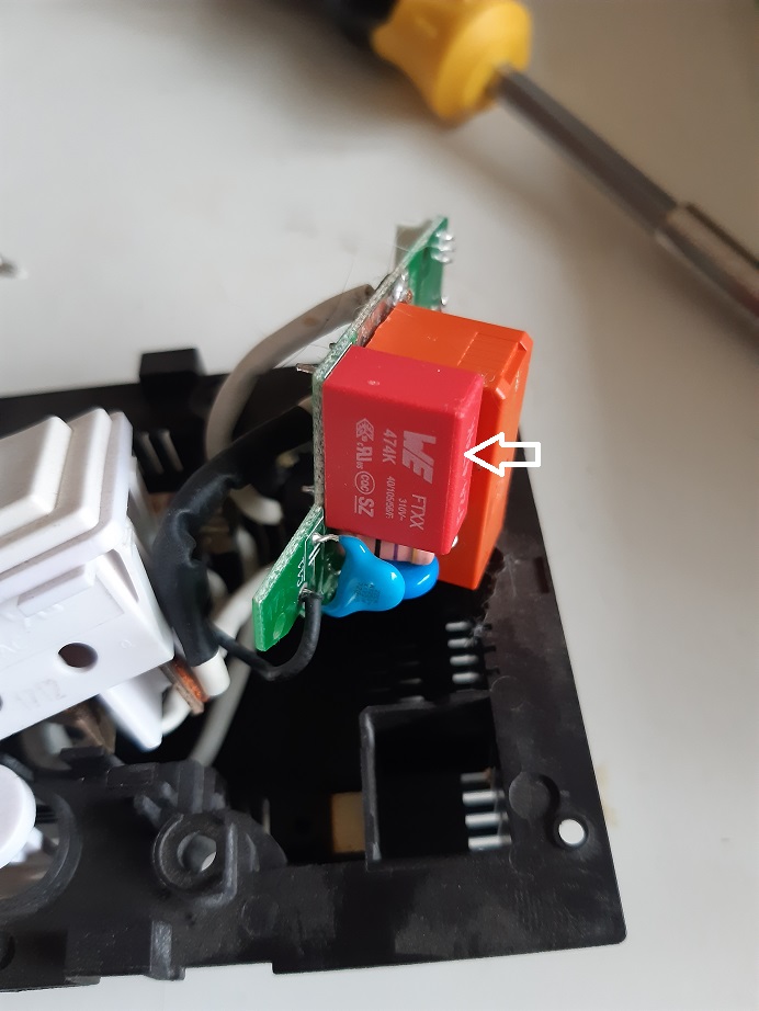

Have you checked the fuse in the KingShield unit?
There might be a small button that you have to push with a pen to reset to factory settings.
These units fail over time. The internal capacitor that drops the mains voltage degrades as it ages such that the powersupply to the relay becomes marginal. Also the zeners fail. Can be repaired but potential very dangerous and not recommended.
I've repaired a few. As you say it's normally the dropper cap that fails. Never had a zener fault (yet!). I wouldn't say it was dangerous as long as you use the correctly rated replacement.

Hello @Moley
Would you please identify which capacitor you found defective and had replaced? Is it C12 or C13? Those are surface mount type!! Correct?
Thanks in advance,
Phil
I'm working away from home until Friday so can't check which it is but it's not a surface mount.
Okay, I forgot to reply to this when I got back home. Oh well, better late than never.
1 - Remove the 4 screws arrowed in pic1
2 - Unclip switch (blue arrows pic 2)
3 - Remove 2 screws (white arrows pic 2)
4 - Pull out board and 474k cap is arrowed in pic 4
